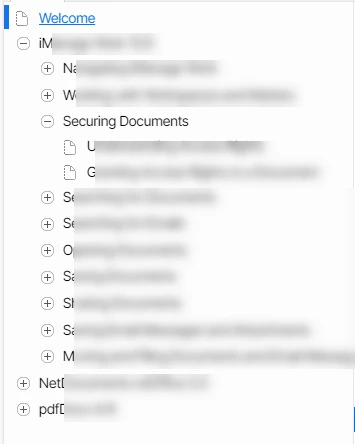

    Nov 20, 2023 6:25 PM UTC
    Can you post some screenshots showing what's happening?
    Nov 20, 2023 6:56 PM UTC
    Thanks for replying.

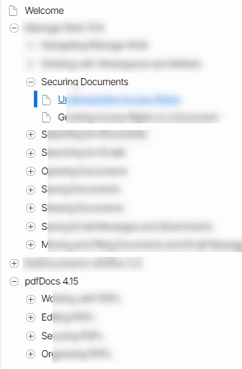

    In the graphic below, if I click one of the items in the expanded Securing Documents group, the pdfDocs group at the bottom automatically expands (see second screenshot).
