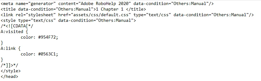

    The topic code you posted usually indicates the content was imported from Word documents. It hasn't typically affected the toc colouring in past versions, but perhaps that's changed with the new Frameless output?
    In two or three topics in Robohelp, switch to code view and look for that code and delete it. You might find it appears in the topic as <body link="xxxxx" vlink="xxxx"> - just delete the link and vlink text, rather than the whole tag.
    Generate and see if switching between those topics now shows the toc items the correct colours. If yes, you should be able to do a search and replace on the code to remove it.

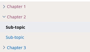

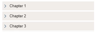

    Dean5EA1Author
    Apr 16, 2021 5:35 PM UTC
    Thank you for the clarification. Yes, I made a new skin copy, not a duplicate. Here is the result of the new skin.
    When loading the page:
    When I click any item in the TOC

    Dean5EA1Author
    Apr 16, 2021 1:32 PM UTC
    I do not see anything in the css file in the asset section to direct "visited" or "link" colors to change. Below is a copy of the source code. I am not sure where to locate these setting, since it is not part of the css file.

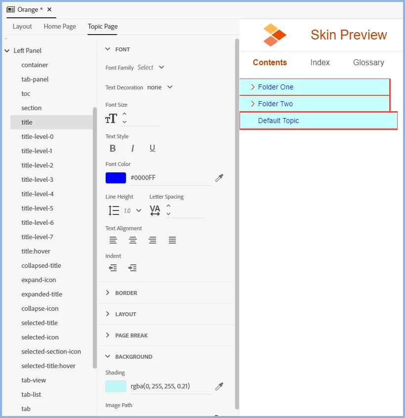

    Peter Grainge
    Apr 7, 2021 2:13 PM UTC
    I just set up the title in these colours and then went to Selected Topic and changed the text to lime green. When I generated the output all the topics show as below except the selected topic when the font changes to lime green.
    So far so good. Next in a topic I added a hyperlink to another topic and it is showing in a different colour. The skin CSS is somehow kept apart from the topic CSS so I'm baffled by why your links are being affected.
    Try some really lurid colours to be sure.

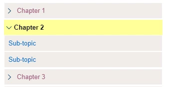

    Dean5EA1Author
    Apr 15, 2021 4:49 PM UTC
    My settings look much like yours, with the difference of color choices.
    The table of contents looks as desired when I load the page.
    However as soon as I select a chapter all of the text color shifts. Note: the yellow highlight is correct in how I set it up to signify the selected topic item to display.
    I cannot figure out where to locate the root cause of the shift when I make the first selection. It does not matter which item is selected, any slection causes this chain reaction.

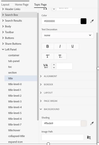

    Peter Grainge
    Apr 6, 2021 6:54 AM UTC
    You will need to look in the skin editor.
