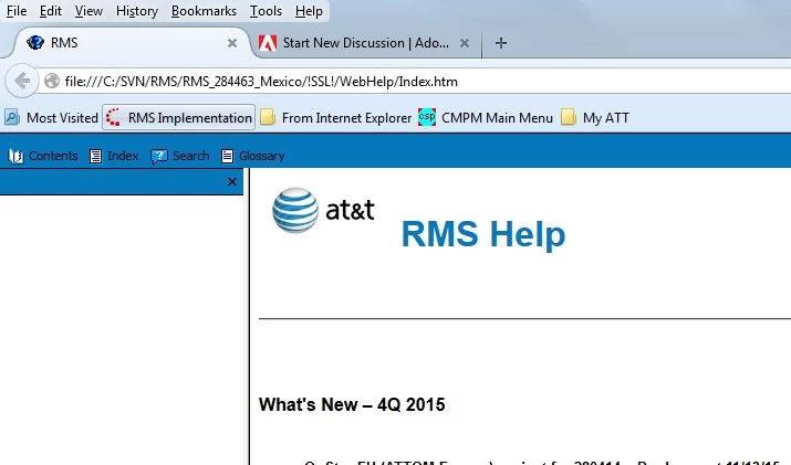

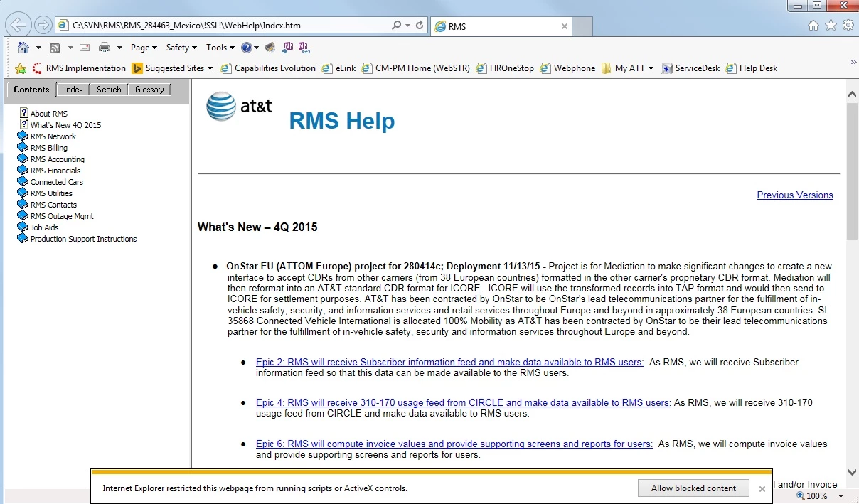

  2. Now, the TOC shows in IE but not Firefox.
  3. I noticed when I launched the index.htm in IE, I got the activex error that I used to get in the past but had stopped getting after selected "Allow blocked content."  I select again to "Allow blocked content" and I was able to see and use the TOC on IE.
  4. When I tried to access the same in Firefox, I get no warning, but I still have an empty TOC.
  5. The .HHC file is there in my WebHelp directory and I use the same source for IE and Firefox.
