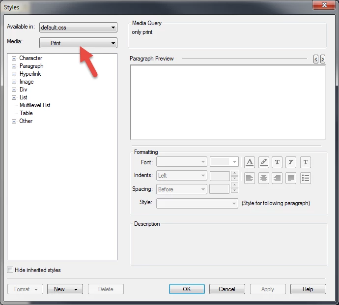

To style your table for printing:
  1. Open the style sheet through the Project Manager.
  2. Select Print as the Media of the CSS:
  1. Update the CSS as you would regularly do.
If you want to set the width of tables through the CSS, open the style sheet in Notepad or another text editor and find the table style. Add the following to the table.myName (replace myName by the name of your style):
width: 100% !important;
You table will now always be 100% the width of the page.
