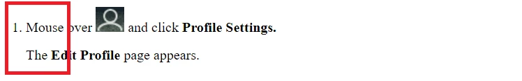

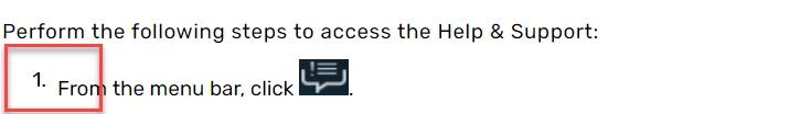

I created a stylesheet and defined the styles for both numbered and non-numbered lists. The list works fine if no image (icons) are added to the text. If an image is added to the text, there is an issue with the alignment of Text and number. Please refer to the image below:

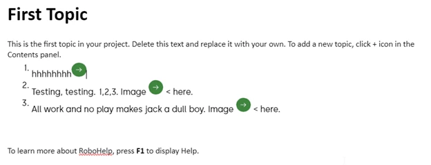

    Hello.  My first time commenting here 🙂  I've enjoyed your content so far.  Recently, I stumbled across the same issue Divya is having.  Here's what I discovered > basically, this problem with inline images with numbering only seems to occur when you change the "Numbering" away from the default.  I've tried it with several different texts, and encountered the same issue.
    Here's what I did, starting with a new project as you suggested:
    • The above is with an inline image with all of the default style sheet settings from the original default.css file.  Next, I decided to change fonts.  Changing the List style ol.Decimal, I changed both "Numbering" and "Content" to use a different font.  This resulted in the offset as shown below:

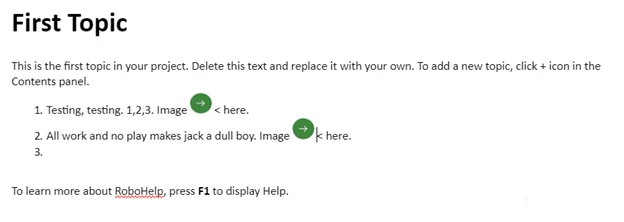

    • Once these changes were made, I reverted back to all default fonts on my ol.Decimal style, but strangely the offsets remained.  To do further testing, I had to start another project to get to the stage where there is no offset any more.

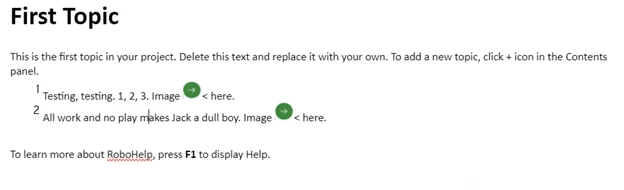

    • Next, with another new project started, I decided just to change the "Numbering" font.  As you can see below, this introduced the offset:

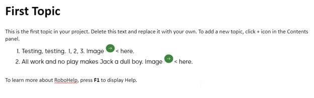

    • As mentioned before, at this stage, even if i try to revert back to the default font, Robohelp seems to be "stuck" with this offset.  Again, I started another new project an only changed the Content to a new font.  I'm happy to report that the Inline text/images seems to work with no offset!  See below:
