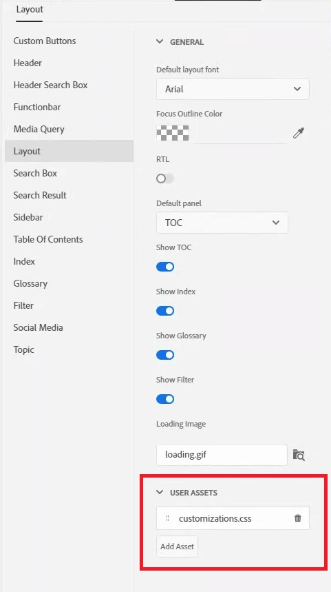

If I'm understanding right, you found the css you think is causing the problem with the iframe size. Add your changes to that style into a custom css file and add that file to the skin in the User Assets section of the skin. I posted an example screenshot of where to add the file earlier in this thread. The interface might be a little different but hopefully it gives you an idea where to look.

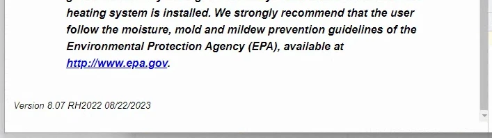

September 1, 2023
I think this is going to work. It will be a month before I make it live on the WordPress site, but the issue was present when it was running locally and is now fixed locally.

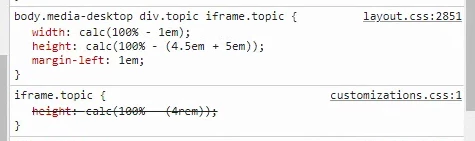

Here is the only code in customizations.css in the skins folder:
iframe.topic {
    height: calc(100% - (4rem));
Maybe it is supposed to be this way, but I noticed at desktop size that layout.css trumped customizations.css:
I wanted to add that this is where customizations.css is added:

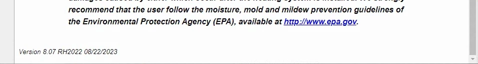

And the results:
Its not perfect, but at least all of the content is visible.

Here's an example of where to find the User Assets section of the skin. As I mentioned, it will vary depending on the skin and also which version of RH you have installed. Hopefully it points people in the right direction though.
