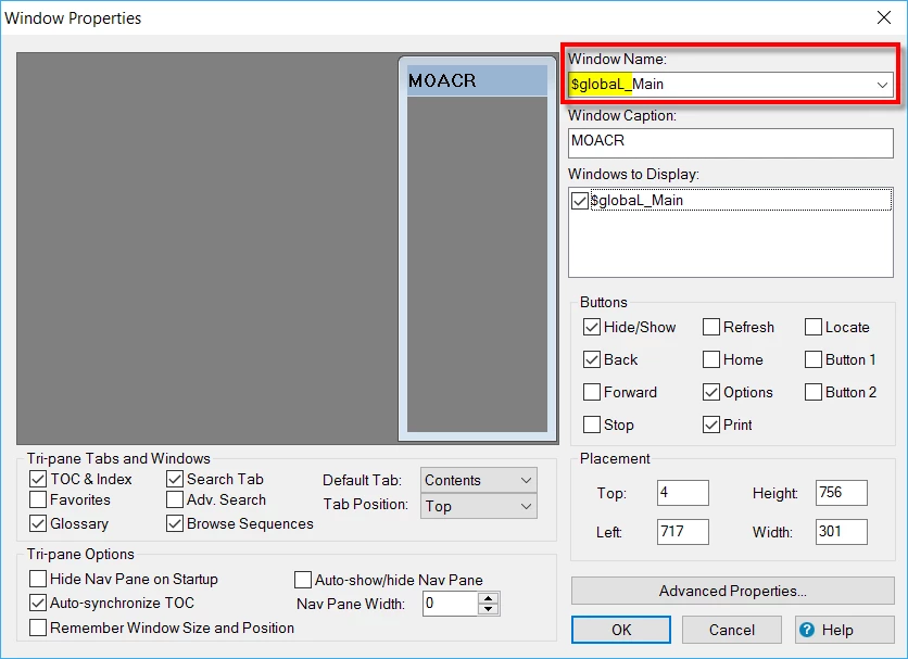

I found an old thread for a slightly different problem but mentioning that you need to configure your window names so they begin with $globaL_ in all projects.
Click here to read the thread. The information you want was posted by Dirk Bock (which isn't much more than what I provided earlier) is at the bottom of the thread.
