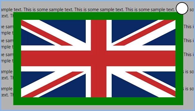

    @Peter Grainge Just in case you want to try this yourself, I think I have cracked the code 😉
    Rather than position the "X" inside the popup as I originally had it, I decided to try to center it on the corner rather than leave it so far above the popup. Here's the result:
    To my eye (and my co-worker's), this looks centered. Here are the settings I used:

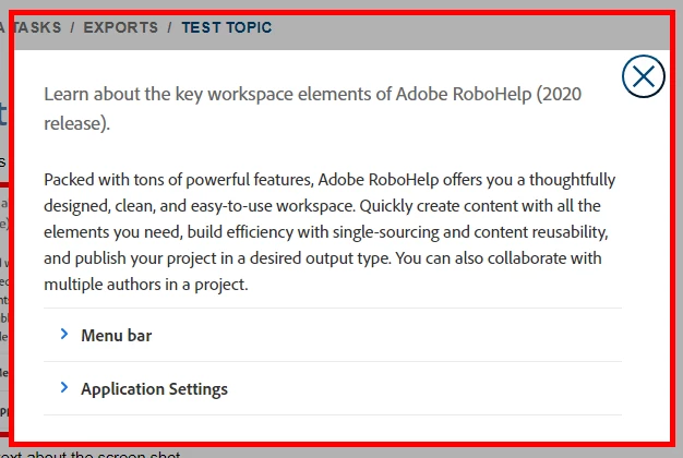

    Brilliant! I totally missed the fact that you and Amber were talking about different styles.
    I first applied the border to .RH-LAYOUT-thumbnail-container, but .RH-LAYOUT-thumbnail-image is the right one. So now the border surrounds only the popup and doesn't add any space at the top. (The button position may need to be adjusted, but I'll experiment with that after I decide on the correct border width.)
    I can't tell you how much I appreciate your help on this!

    Jul 22, 2022 4:51 PM UTC
    What I posted looked fine this morning but now I come back to it, I am seeing this problem.
    Have you tried using the styles that @Amebr posted?

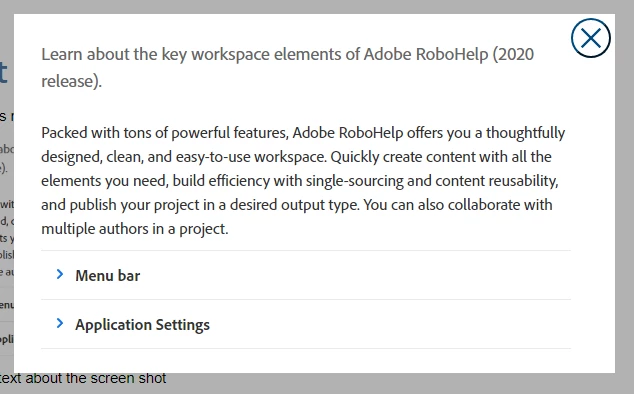

    But now that I tried putting the border around the pop-up, I'm having a new issue. By default in the Studio skin, the thumbnail close button was a white "X" on a white background, so we created a new image in blue. I also moved the position of that button a little. So the "before" pop-up with no border looked like this (I'm using a screen shot from Adobe.com since I can't share my actual work):
    But now that I've added the border per Peter's instructions, the "after" pop-up looks like this:
    I'm not sure what I've done wrong, but it seems to have added a lot of space (not white border) to the top of the pop-up only. Below is the code I had added to my user asset .css to replace the button and change the position.
