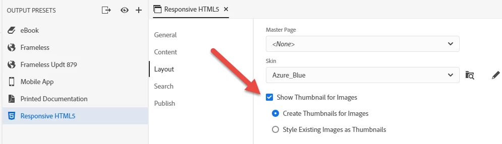

Did you check the Output Preset settings? While important to tick "Use thumbnail" in Image Properties, it's also easy to forget that you must also enable use of Show Thumbnail for Images in Output Preset.

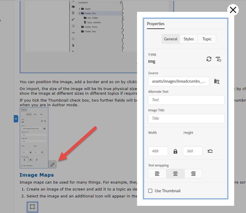

Here is what it should look like in the generated output after the user clicks on the diagonal corner arrow..

Thank the gods I came upon John D's solution in this thread. Following his solution, I edited my output preset selecting "Show thumbnail for images."
Now I no longer get the "restart" error.  THIS SEEMS TO BE A BUG, NO?
