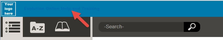

Please help - this issue is sapping up valuable hours and I can't find a solution. I've created a nice new responsive HTML 5 layout in RoboHelp 11 - however the Title Bar font is not rendering the size as stipulated in the editor.
This seems to be project specific as I can use stock and other Screen Layouts with the same result. I exported my custom Responsive Layout into a new project and it behaved as it should.
The generated result I get (illustrated above) has an incorrect font size in the Title Bar, the point size of this font should be much larger. I've checked through just about every project setting and I have no idea why it is doing this.

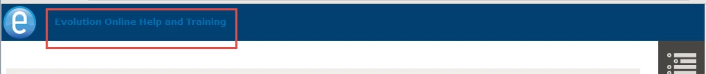

Doing the same with the stock Responsive Screen Layout:
Is someone able to shed some light on this, your recommendations would be greatly appreciated.

Do you have the setting 'Limit scope of project styles' enabled in your SSL?
My guess is that this setting is causing the problem.

Hi - this was a precise fix to the problem. Thank you.
