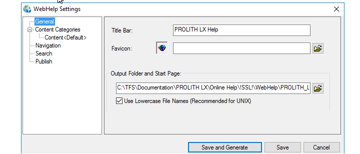

As for the variables, they show up in the User Defined Variables pod. I don't know where to select a set of variables to use during a compile. I have looked in the WebHelp Settings (screenshot attached), but cannot find a setting for variables in any of the options.

Can you show what's on that "Content <default>" screen?
