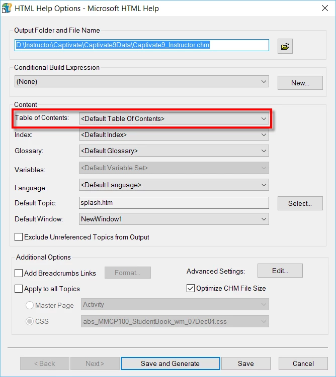

Dec 28, 2015 8:14 PM UTC
Hi there
When you look at the output settings, do you see the correct TOC listed?
Cheers... Rick
Dec 28, 2015 8:23 PM UTC
Thanks for your reply, Rick! Yes, I’ve tried it with both the default TOC selected as shown in your screen shot and with the name of the default TOC selected. Neither one works.
