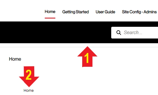

I have a phantom shadow (1) between the header and body containers that I can't seem to get rid of. I've tried changing border colors to #ffffff and clear on both containers, as well as background colors. I've also tried using Chrome Inspector and canceling any grays coming from the userstyles.css. But I still haven't been able to find the source.
Also, a mysterious paragraph with the page name appears at the top of the body container (2) just below the breadcrumb. This only shows on the home/landing page. Any ideas on how to get rid of either of these, please?

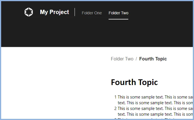

    Kevin5FC2Author
    Aug 3, 2021 11:49 AM UTC
    Thanks for the reply, Peter. It was a master page causing the phantom Home paragraph. As for the shadow line, you can't see it in your output because you have a black background. If you disable the background in your browser's inspector (line 1500), you might be able to see it. Here is a screen shot from my test output.
    Peter Grainge
    Aug 2, 2021 12:39 PM UTC
    1. I am not seeing that in an output using the default Top Navigation skin. Guessing it is something you have done when customising. Try a fresh copy of the skin.
    2. I am not seeing that either without master page applied but I do if I use a master page with breadcrumbs. As the skin includes breadcrumbs you don't need them in a master page.
