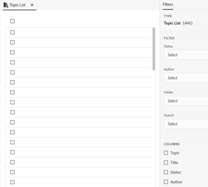

    Peter Grainge
    December 31, 2020
    Your screenshot doesn't show the Properties panel on the right. Also you haven't said whether you have looked at the bug that was reported.
    Three issues were reported and Item 2 could be relevant. It is an Open report meaning it hasn't been fixed yet.

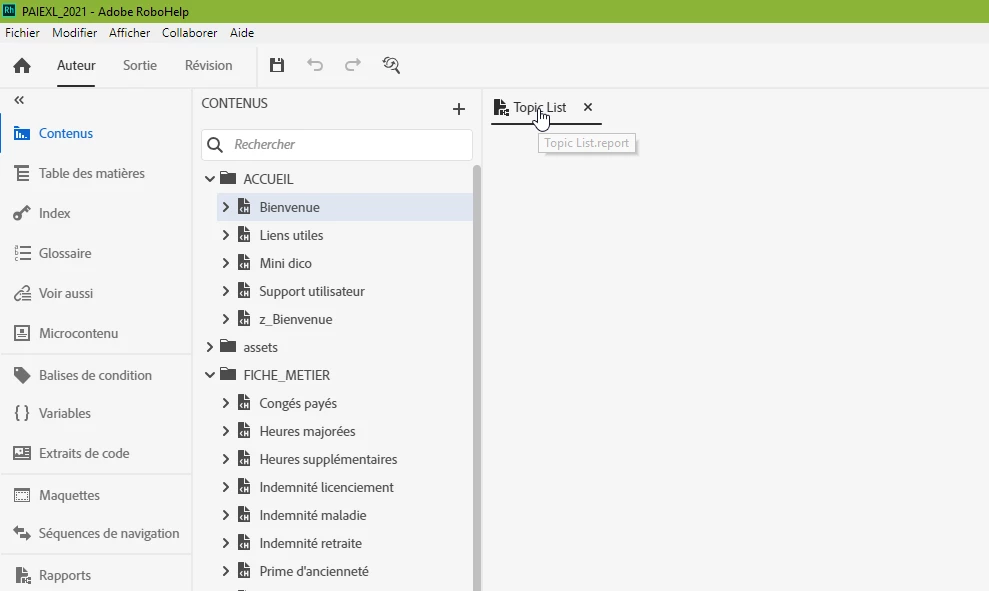

    December 30, 2020
    I use Robohelp 2020.3.32 and I have the same problem.
    Empty Topic list.
    Everything was fine in the previous release (2019).
    Did you solve this problem ?
    Thank you.

    In case it helps anyone else with this issue, I just encountered it and found the solution as a restart did not work for me.
    I had a filter applied that gave me three topics. I clicked the link to each, made changes including the status and saved. On returning to the topic list it was blank and showing no filters applied.
    When the restart didn't work, I found other reports were working so a bit of head scratching. I then selected a filter and got the results for that filter. I then removed the filter and hey presto, all topics restored.
    Needless to say, I have reported this.
    April 29, 2020
    Do you have at least one column ticked in the filters panel? If you untick them all you'll only see checkboxes and no information in the report.
    April 29, 2020
    No, that wasn't visible either - it was just the table head and a blank page below it.
    BUT: After a computer restart, all works fine now. Well, kind of - it's somewhat slow, and the sorting isn't reliable at all. But the table rows show up.
