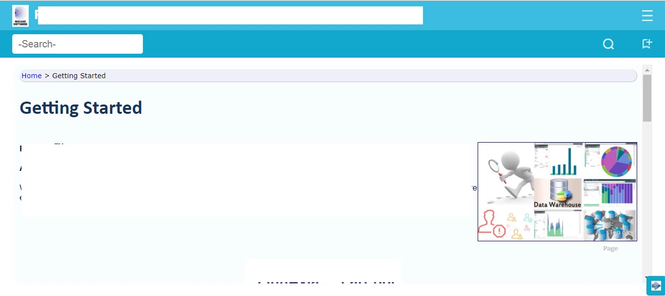

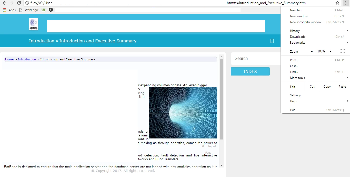

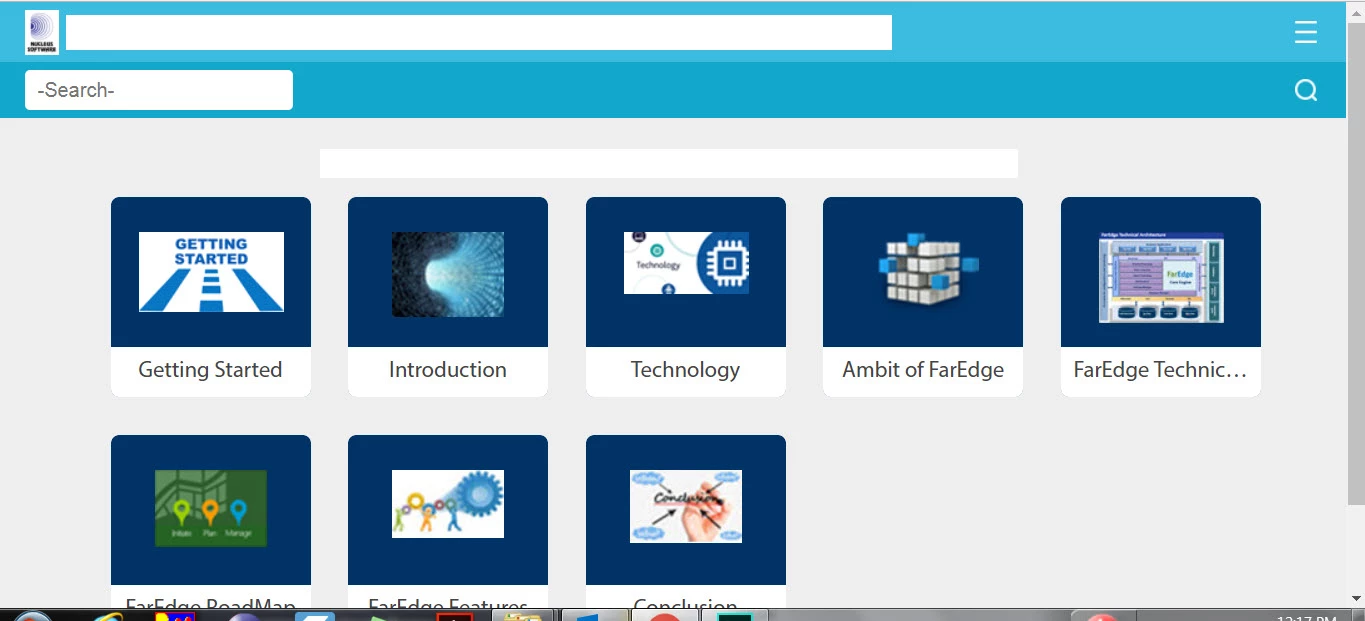

1. While i am generating the Responsive HTML5 output using Indigo layout through Robohelp 2017.
The topics and pages that opens, opens up at 100% zoom on my desktop, but when i am providing the same output to the others the pages are opening bit minimized.
Please view images:
On my system at 100% zoom the output can be viewed as: For the main page
the above image is at 100% zoom on my desktop Main page.
For topic plz see below image
While when i provide the same output to some other person and they opens up that on their location, then the output is viewed something like this:
