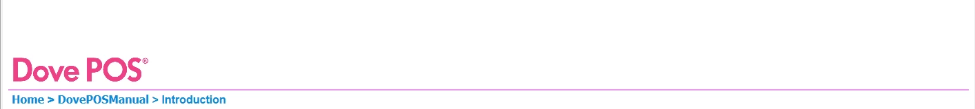

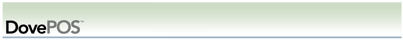

    Sorry for the confusion; I was able to get a no-border style applied to the layout page with your code above. I wasn't able to resolve the repeating background image problem, but I was able to get around it by inserting a basic image with a white background into the table and leaving the remain space unused, where the previous logo had a shaded background that needed to fill in the empty space. I simply set a solid border on the table for separation. Example below.
    New:
    Old:

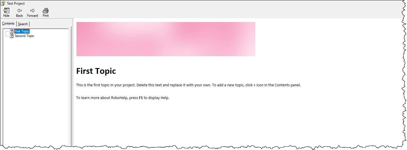

    This is a chm I generated with the image deliberately blurred.
