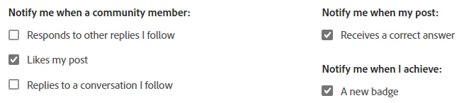

    Peter Grainge
    Oct 6, 2021 7:39 AM UTC
    Those settings are independent of following a forum. To get notifications of the Announcements you have to follow the forum and will get emails of all posts. That can be useful for "I didn't know that" bits of information but if that is too much, then you will have to stop following the forum generally, then you will not get emails for the Announcments either. You will still get emails for your own threads.

    Oct 6, 2021 7:29 AM UTC
    By following, I got many emails of posts. I changed my account settings > notifications as follows, but still get emails of posts.
    How should I set notifications settings to only get an email of my posts and posts that I marked to follow?
