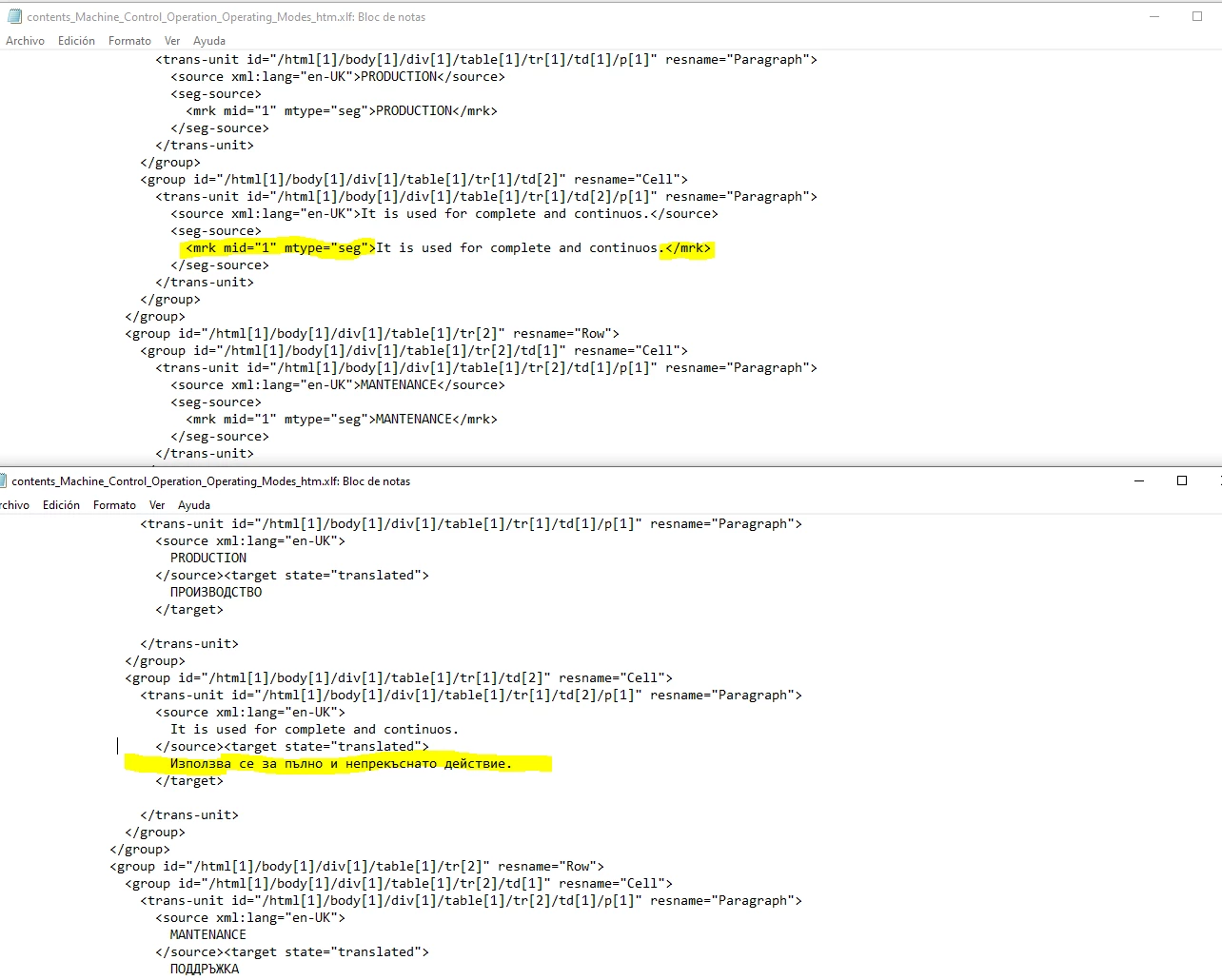

    SOLVED! In our case what happened is that the external translation agency that does our translations uses Trados Studio, and they had an option that removed the MRK tags, so the translated text was not displayed. In the image, above the original, below the translated text returned.
    The solution was to put the tags by hand, to verify that this was the problem and it worked. After this, we informed the agency of the problem and they changed some options in Trados Studio, and it no longer removed these labels (sorry I can not say which options, since it is a matter of the agency, but it is a question of settings)

    I have the same problem as you, I have robohelp version 2022.1.188, I have already done several translations using the xlif with success with an external company that gave me back the translated xlifs and I had no problem.
    But since 2 days ago, when I import the xlifs files translated by the external company, the code in the file is correct, but when you do the import in the final project everything disappears. I check that everything is correct and it is, except the import. I repeat that I have already done it many times with success but since a few days ago it doesn't work. I have tried to edit the translated text but it doesn't recognise it either. I am doing it with Bulgarian, which I have already done several projects before without any problem.
