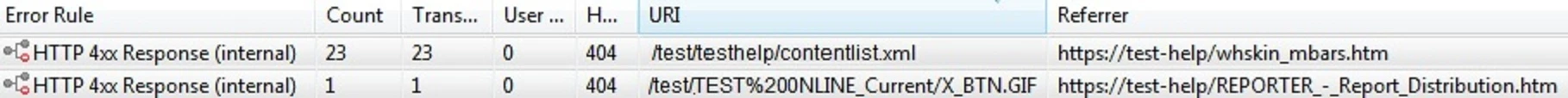

I'm using RoboHelp 9.0.2.271 on a Windows 7 64-bit machine to generate a WebHelp project. Everything appears to be fine in the source files and in the output files when I test locally and/or in a build.
I received a message from development that they used something called dynaTrace to test for errors in the build. They sent a list of seven 404 errors logged by the application. The list looks similar the attached screenshot of two (fake) examples.
When I look at the folder where I deliver the output files to development, I see all of the files that are listed under the URI column and the Referrer column, with only a few exceptions for two of the entries. I'm not familiar with troubleshooting the help in this manner and was hoping someone else can shed some light. There are no apparent broken links in the project.

Can’t make out your screenshot, but a 404 is a page not found – have a look at the pages they’re reporting and see if there is any dead/broken links in them.
Mar 3, 2014 9:56 PM UTC
Thanks, Jeff. When I went to the pages listed in the Referrer column (btw - you may be able to click the image in my message to zoom in on it), and then located the files listed in the URI column, something odd happened. When I double clicked the applicable link in the RoboHelp project, everything looked set up correctly. However, some of the images didn't appear correctly when I used the "View Selected Item" (glasses) icon to view them. So then I opened the link again in the project, navigated to the exact same graphic, and then it seemed to reload the image. I'm sure this isn't making much sense. I vaguely remember a bug from years ago that caused this to happen (where after upgrading, certain images lost their links), so maybe that's at play. This is a large, inherited project. They're going to run dynaTrace on the updated files in the morning, so I'll know then if "re-linking" the images fixed the issues. Fingers crossed.

Adding some updates in case any of this rings a bell for anyone. Development did another build last night and ran dynaTrace again. The graphics I re-linked yesterday no longer appear as missing. However, in today's report, additional graphics appeared to be missing (that didn't show up in yesterday's report). One was in a topic that was impacted yesterday for a different graphic (which didn't appear as an issue yesterday). Another one was in a different topic that was not impacted before. Again, when I open RoboHelp and look at the topics and images, they appear to be linked properly. I am not familiar with how dynaTrace actually tests for missing files. RoboHelp shows no broken links or missing images. Not sure yet if it makes a difference, but most of these "missing" images are located within expanding hotspots.
I did find some info on the one file that showed up yesterday and today. The /test/testhelp/contentlist.xml file is missing from the /test-samplesite/test/whskin_mbars.htm referring page. From what I understand, this file is only needed when DUCC is used in a project. We are not using DUCC in this project.
