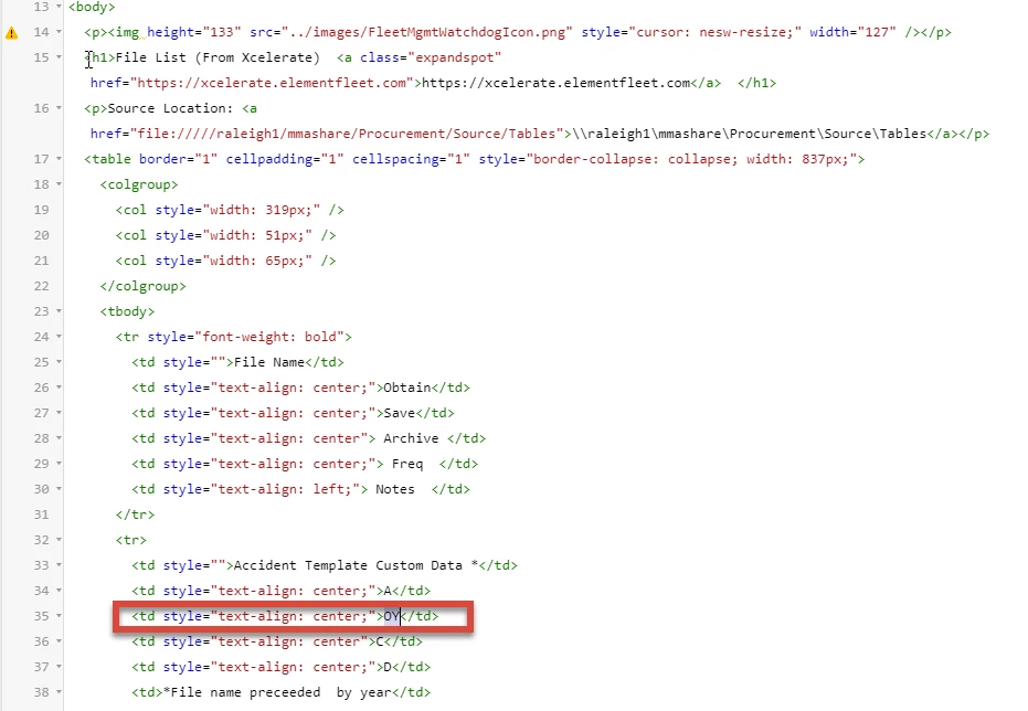

    Apr 25, 2022 6:41 PM UTC
    Here is the example.  The text "OY", "File" and "preceeded" all show as Type Span.  The rest of the page shows as Type td.  I remove the formatting from the bad text, save. and it all looks ok.  When I re-open the file it goes back to the unwanted formatting.
    Here is the HTML.
    Jeff_Coatsworth
    Apr 25, 2022 7:34 PM UTC
    That appears to be inline styling applied to most of the content - the offending line doesn't seem to have any style on it, so I would expect the CSS to control it. If you add words to that cell, are they saved?
