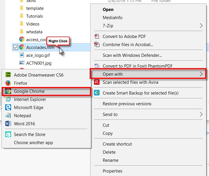

If you are unaware of how to change the file associations, open Windows Explorer. Look at the icons representing HTML files. Likely you will see Word icons.
Right-click one of them and choose the Open With option. Then choose your browser icon.
Note that the option I'm showing is choosing Google Chrome. If you prefer IE or Firefox, feel free to chose one of those.
Cheers... Rick
