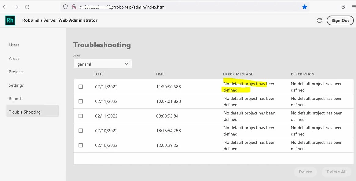

I'am facing an issue here, after generating projet on RH 2020, i tried to publish it to my RH Server 11 but no chance !
I have this message on my RH11 server after the publication : No default project has been defined
Communication between client and server is OK,
Do i have to do something on the apache tomcat ?
I spent 2hours yeterday with adobe support but no chance to fix it.
In the publication logs i have this :
initializing publishing to rhs11Profile
Requesting metadata from server...
Response status:200
Setting publisher...
Response status:200
checking for rhlog.txt ...
Response status:404
Uploading //corp.mycompany.ca/users/myuser/My RoboHelp Projects/outputs/TestRH11S/Responsive HTML5/assets/css
Successfully uploaded //corp.mycompany.ca/users/myuser/My RoboHelp Projects/outputs/TestRH11S/Responsive HTML5/assets/css
Sending publish finish status.
Response status:200
Publishing finished
Anyone can help me please, i'am stuck.

    metro5E8AAuthor
    Feb 16, 2022 5:52 PM UTC
    Publication is working fine now, locally and from deported win10 client.
    The issue was comming from the tomcat service that was not running through localsystem or by using a useraccount with sufficient access rights on the publication folder and/or program file folder.

    Is this new or it's just started happening? Have you tried generating locally & copying the output manually to the webserver?
    metro5E8AAuthor
    Feb 11, 2022 6:46 PM UTC
    It's new, it's a new infra with robohelp server 2019, and win10 client with robohelp 2020.
    Yes, we are able to generate locally, but when publishing we are facing some issues, i am trying to know what;s happeing actually. Is there any logs to check ?
