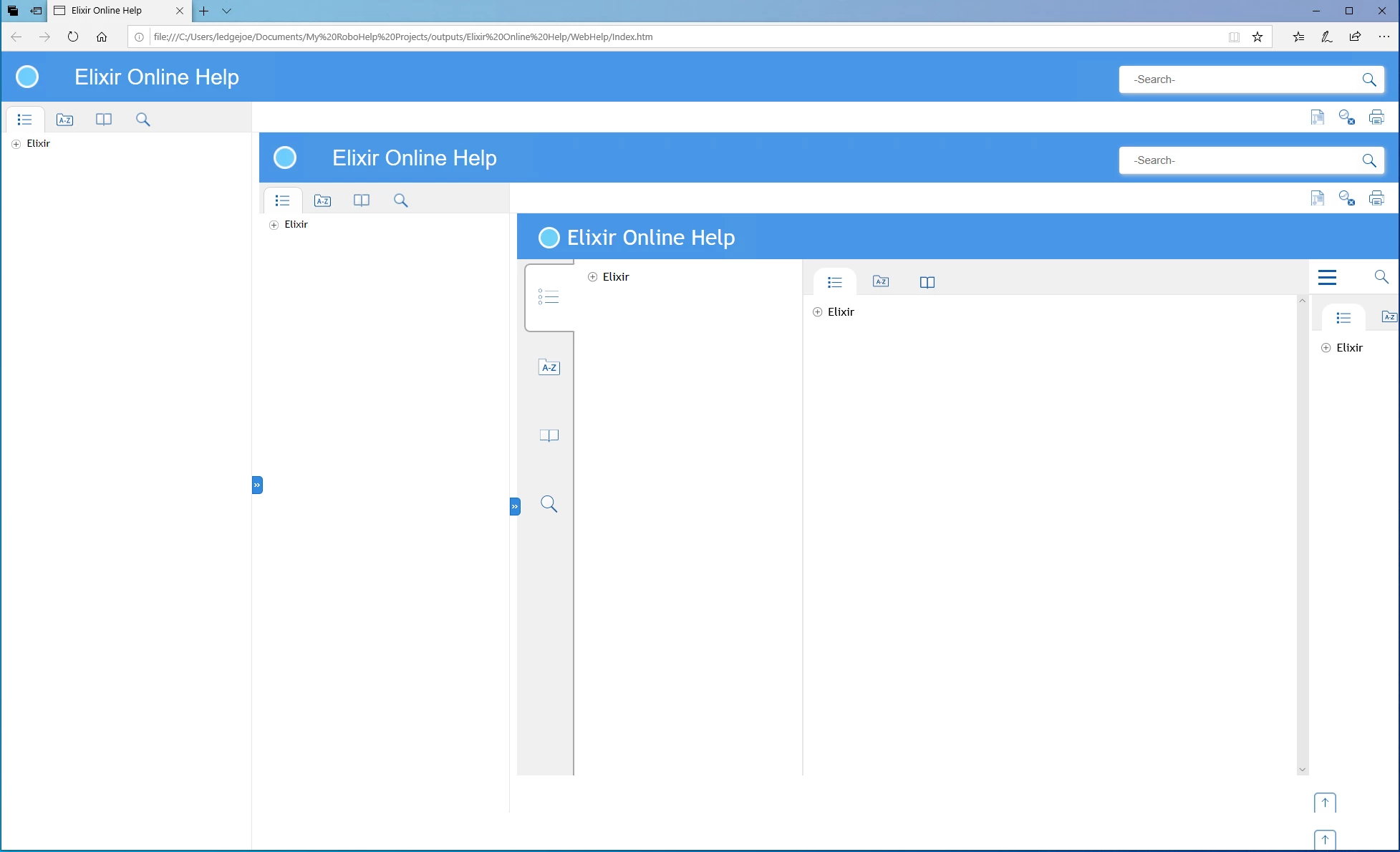

    Peter Grainge
    Aug 18, 2020 6:32 PM UTC
    We are saying webhelp doesn't exist any more because it doesn't. What you are seeing is a preset that was named WebHelp in Classic. Click the + icon to create a new skin and try to find webhelp.
    my collegue was the one who upgraded the project from modern to classic
    I assume you just got that the wrong way around. You upgrade from classic to modern. The new version has an RHPJ file and does not have an XPJ file so I cannot see how you were running your colleague's New UI version in Classic. Are you sure you weren't opening the old project as upgrading to the New UI leaves the old project untouched.
    The usual cause of an output seeming to be embedded is someone has set the default topic to be the start page.
    Also if you look in the preset configuration you will see a skin must have been set. If one is not selected, quite simply the generation stops and tells you that.
    Have a good look at the settings and I think you will find the cause of your problems.

    Joe@MajiqAuthor
    Aug 18, 2020 5:46 PM UTC
    Ok, so, my collegue was the one who upgraded the project from classic to modern. I just didn't realize that he had updated RH to do it. I was trying to run his upgraded project with my older version of RH. So, once I upgraded, I was able to generate the output. I chose WebHelp, and didn't apply a skin or make any changes. The output looks like this in Edge, IE, and Firefox.
    I then applied a skin, but had the same results. Any thoughts on why the page is being embedded in itself?
    Also, I am seeing WebHelp as an option. I'm not sure why people are saying it isn't available.
    Edit: The project was updated from Classic to Modern (not the other way around as originally miss-stated).

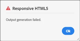

    Peter Grainge
    Aug 18, 2020 6:58 AM UTC
    Before you panic after seeing that webhelp is no more, the responsive and frameless skins have a setting that stops the layout changing as the window size changes. That said, why would you not want that?
    Aug 18, 2020 1:40 AM UTC
    Right-click on the output preset name and you should see an option to view a log file. That might offer some clues.
    Also, WebHelp no longer exists, so some of your setting may have been unset. I'd double-check all the settings, as you'll have been transferred to a Responsive HTML5 by default (regardless of what the name of the preset is).
    Joe@MajiqAuthor
    Aug 17, 2020 7:49 PM UTC
    Well, I was able to use one of the options available (I'll adjust it as I figure things out), but when generating the WebHelp preset, it processes things for a while, and then I get the error, "Responsive HTML5 Output generation failed." And there's no indication why it failed. Can anyone point me in the right direction? Thanks!
