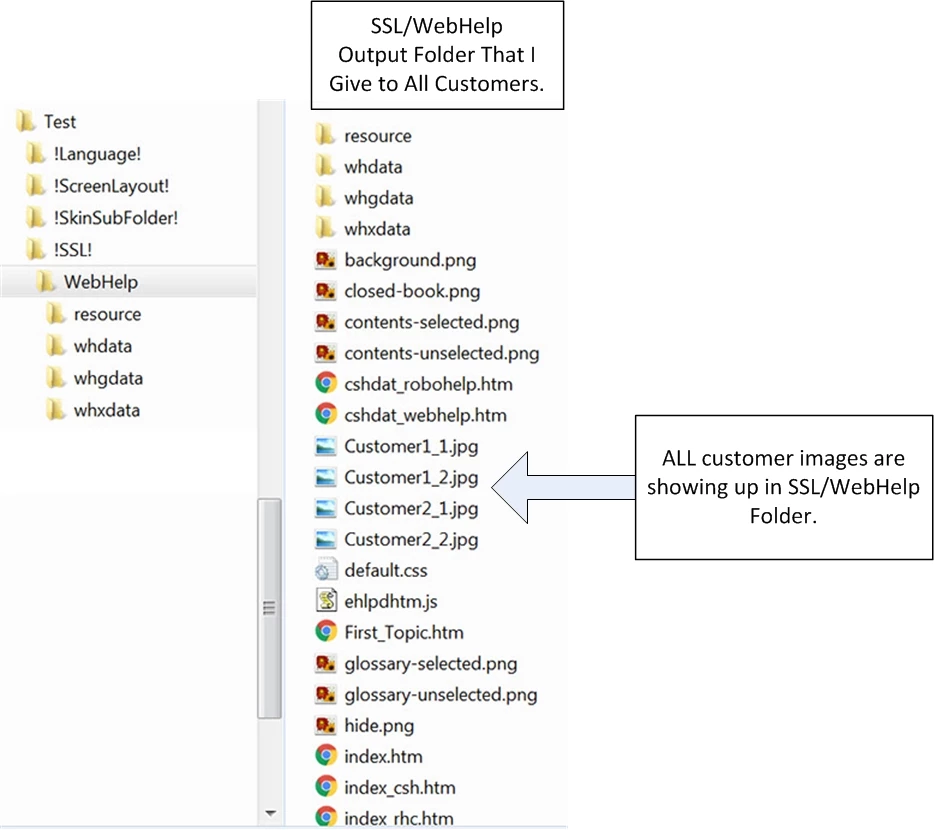

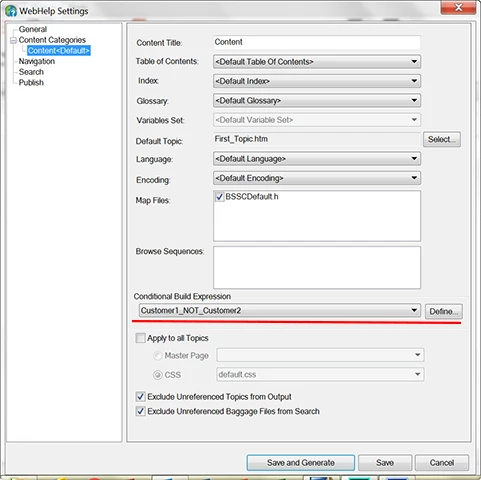

I created 1 project using WebHelp and Conditional Build Tags to generate help for our different customers. I apply the Conditional Build Tags to different drawings in the project so each customer can only see the drawings for their particular "flavor" of our equipment. When I generate the project, it works fine.
Here is the problem...
All of the drawings remain in the project output folder (SSL folder) that I have to distribute to the customers.  Someone actually poked around in the folder and asked me about the files for other customers.

I think I see what is going on here. It used to be the case with WebHelp that whatever was in the folder you generate to got stripped before you generated each time. The simple test was to dump a file in the output folder and see if it was still there after generating. That used to be the case but it seems that has changed along the way.
There are two solutions.
  1. Before you generate, manually delete everything from the folder to which you generate. Not the best as it is too easy to forget.
  2. Create a duplicate of the WebHelp output and point each one to a different output folder. Label the outputs as WebHelp Customer 1 and WebHelp Customer 2 and so on and have folder names to match.
You could either generate each layout as and when required or use Batch Generate to generate them all at the same time.

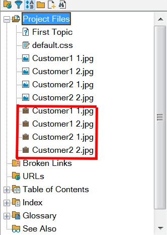

I think baggage files always get included in the output, regardless of any conditioning for references/links in the topics. And you can't condition baggage files (unless something has changed in RH2015 or RH 2017?).
So if the images are all referenced in your topics and conditioned, then you shouldn't need to add them to the baggage files as well.

3.  I did a new test project and the customer image files for ALL customers are still showing up in the SSL/WebHelp folder. That is the problem. A customer poked around in the source files.
4. For Source Control, do you mean how do I handle the drawings? I put all drawings in the Baggage folder. Is there some other way I should handle the drawings for different customers???
5. How I generate WebHelp with Conditional Build.
