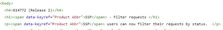

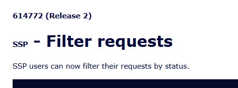

Variables don't use applied style in RH2022
I'm using RH2022.5.28.  We're looking at implementing variables.  But when I add a variable to a heading it doesn't display using the heading style.  The heading is bold and uses a larger font size.  It displays as bold but not in the larger font size.

    Nov 7, 2024 3:28 PM UTC
    Unfortunately that isn't what is happening for me at all.  It does exactly what I've shown in my screenshots.

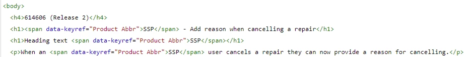

    Peter Grainge
    Nov 7, 2024 12:39 PM UTC
    Your code is wrong.
    Adding a variable to a heading my code is like this.
    <h1>Second Topic <span data-keyref="Variable 1">Variable 1</span></h1>
    Your closing span tag is in the wrong place. If you drag the variable to the heading, it should write it as above.
    Please use the photo icon to insert images within the post. Seeing an image inline with the text makes it easier for anyone answering or viewing the post.

    Nov 7, 2024 12:51 PM UTC
    I don't understand, sorry.  I don't want the variable text at the end of the sentence though, it needs to be at the beginning with text after it, so the span can't be at the end.  And I didn't write the code, that was put in by RH when I inserted the variable.  I didn't add any code to the variable itself.  I'm confused.

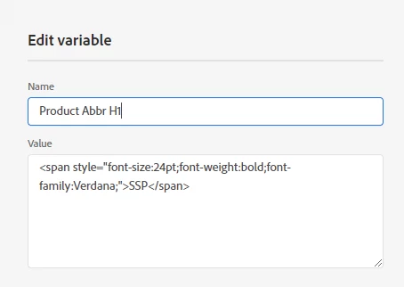

    Nov 7, 2024 1:02 PM UTC
    Even if I put it at the end it still doesn't display properly.  Am I misunderstanding this?
    The only way I can get it to work is if I create another variable with the styles applied in the variable itself.  So I need a different variable for each heading style it could be used in.

    Nov 7, 2024 11:59 AM UTC
    No. It doesn't seem to work like that.  If I insert variable text into a heading, it doesn't use the heading style.  I have to create another variable for each heading style.  As described in the link I was provided.
