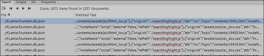

    Aug 3, 2022 12:37 PM UTC
    Oh well, that second screenshot tells you what files to look in for the code which will be easier than the json file. 🙂

    Aug 3, 2022 12:34 PM UTC
    You don't want to modify the json file as it's a behind-the-scenes file that's updated automatically by RH.
    I think the code is saying that first line is somewhere in a file named 19421.htm. The second line I can't tell because I can't see the code. The third line in a file named 19425.htm. Hopefully that helps you work out what to look for.

    I did find it. Used Dreamweaver's Find function for a more in depth look at the files in this help file's directory. Here's a snip of the results. Having found it, however, not sure what to do to correct. Any ideas?
