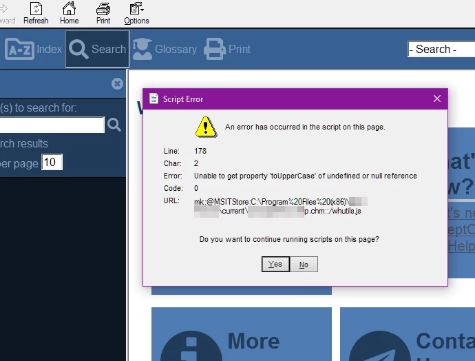

Webhelp gives "Unable to get property 'toUpperCase'" on search after using the Webhelp to CHM tool

I then used the Webhelp to CHM Conversion tool. Everything seemed to work fine, but clicking search gives this "Unable to get property 'toUpperCase' of undefined or null reference. It tells me which line the error happens on and which character. This error is a showstopper, as no matter which option I select, the search DOES NOT WORK.
I tried the same thing with every single skin available, same error.
I tried one of the sample files, same error.

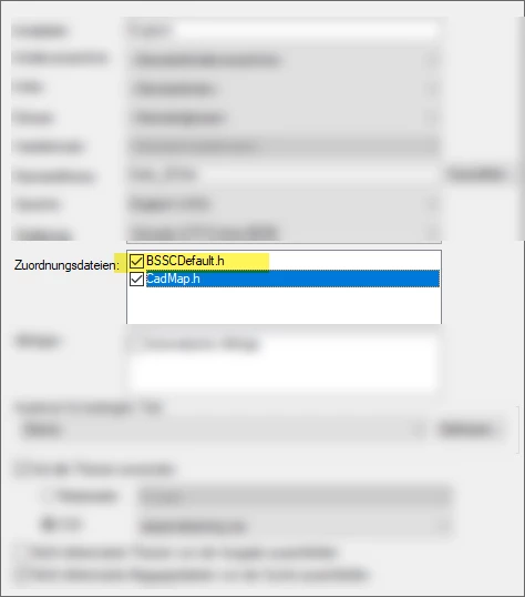

I had a similiar problem several years ago.
It could be interesting for you if you work with map files, too.
When we changed the process from "chm" output to "chm via webhelp" output, a similar (or identical - I can`t tell you anymore)
error message appeared. Our solution was to activate the BSSCDefault.h. We never worked with this map file, our chm projects handled with our own CadMap.h map file.
Good luck!
