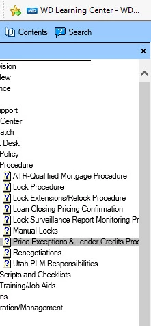

I would like to get the horizontal bar on the left navigation pane to reset to 0 position OR specify width of left navigation pane to fit longest topic title. Once I generate WebHelp and view in IE, I see:
When I begin browsing through my topics, left navigation pane creates a horizontal scroll bar that cuts off the left side (as shown below):
Horizontal scroll bar is:
The users must drag the bar to left position if they want to see TOC
Is there any way around this? Thank you.

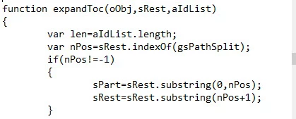

Hi William,
Thank you so much for your reply. I believe you've found the solution, however, my java doesn't match your java. Here's the spot I've isolated in the 'whthost.js' file:
Could you confirm if this is the right area and which line would be commented out with the double //

I was able to find a javascript programmer to modify the whthost.js file. Adobe RH dev team should add this to their 'to fix' pile.
