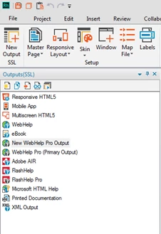

Peter Grainge
May 8, 2018 7:18 AM UTC
When you right click in the output pod, you can create further outputs and more than one of any type. What has happened here is someone has created a second WebHelp Pro output and left it with the default name of New WebHelp Pro.

May 8, 2018 6:44 AM UTC
Can you post a screenshot of where you're seeing this? I suspect it's in the Single Source Layout pod (possibly called Output pod in RH2015 and RH2017 - you didn't say which version you're using) and if it is, it's just the name of the output configuration file, not the actual output itself. But please post a screenshot to confirm.
May 8, 2018 7:19 AM UTC
I'm using RoboHelp 2017. Here is the screen image.
If it is the same output but different config file, then what is the difference between WebHelp and WebHep Pro, plus pros and cons of each?
Peter Grainge
Peter GraingeCommunity ExpertCorrect answer
May 8, 2018 7:34 AM UTC
WebHelp Pro requires RoboHelp Server to be installed on the server. It is an additional cost module.
See this page on Adobe's site. Adobe RoboHelp Server 10 - Features
See www.grainge.org for free RoboHelp and Authoring information.
