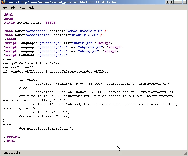

I just changed the WebHelp output file 'whfdhtml.htm'  (From roboHelp 7.0.2), copying the numbers from the "else" row to the "if (gbMac)" row:
from
if (gbMac)
strWrite="<FRAMESET ROWS='55,100%' framespacing=0 frameborder=0>";
else
strWrite="<FRAMESET ROWS='85,100%' framespacing=0 frameborder=0>";
to
if (gbMac)
else

OK. We found the file that has the frame display at 85% for Mac. I plan to change this to 100 or 115...does anyone know why this is set this way to begin with?
*I'm hoping I can make this change in the RoboHelp file without having to change the output file each time we publish the help.
