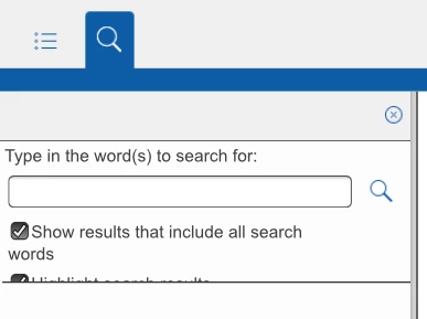

I currently use RH 9. Experimenting with trial of RH 2015. Several issues exist with the search tab in Webhelp run in Safari on iPad -- the same issues that exist in WebHelp I produced in RH9. Are these issues Adobe would ever consider fixing? Or not fixable due the frames of WebHelp output? I have tried Responsive HTML help as an alternative but the drawback I face there is a long time delay with the iPad keyboard recognizing letters I enter in the search field.
Issue 1 - keyboard doesn't close automatically after I click Search or Go on the keyboard (or after I click the search icon). Not huge deal since I can manually close keyboard.
Issue 2 - When the search tab first displays, some properties in the header of search tab are cut off from view. I found a thread earlier today suggesting a work around (manually change a height value in output file), but now can't locate the thread.

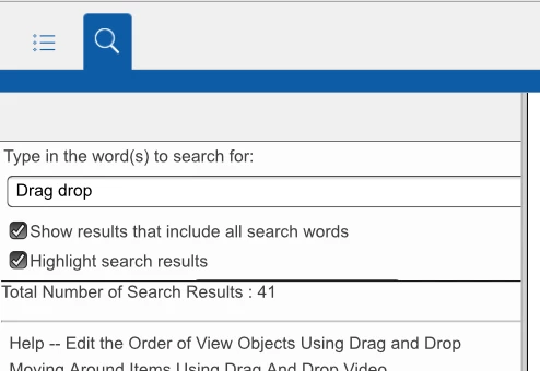

Issue 3 - After a search has been executed, the length of the search field expands right and out of view, also pushing the search icon out of view.

WebHelp is not made for iPad and while it works, you'll run into issues. If you want to support the iPad, you can use Responsive HTML5 output instead. This output was introduced in RoboHelp 11 and improved in RoboHelp 2015. Using the new SSL will solve your problems.
