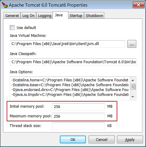

Also, I'm not sure it's relevant here, but you might also check the Tomcat Administration app and its "Java Tab" properties and assure that
the admin specifies 256 as the value for both the Initial Memory Pool and Maximum Memory Pool boxes.
