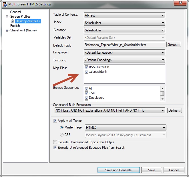

The problem with CSH not working is probably because the CSH is not enabled in the output. In the single source layout settings, make sure that all your map files are selected:

Re. the CSH URLS. For testing, I have a very simple two page help project and have the sole BSSCDefault.h map file ticked and have tried creating URLs as suggested by your very helpful web pages. These work when pasted in to the browser address bar but for some unknown reason do not work when invoked from Java via Desktop.getDesktop().browse(uri); - My logging suggests I am setting the correct URL but all I get is the default index.htm
