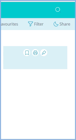

My team and I are customizing the Oceanic frameless template and we want to hide the Mini TOC for our purposes. However, when I disable the "Right Panel" in the layout settings, the print button does not reappear anywhere else in the template. I was thinking I could add it as a new topic page button, but unsure of how to link print functionality to the button. I know users can print from the browser, but we'd ideally like the print button within the help as well. Any help would be much appreciated!

    Oh, if keeping the right sidebar is fine, try going to Mini TOC in the skin, click 'container' and set the Layout > Display field to None. That should just hide the mini toc and leave on the button bar (I'm using RH2019 but I can't imagine they would have removed this customisation in newer version...)

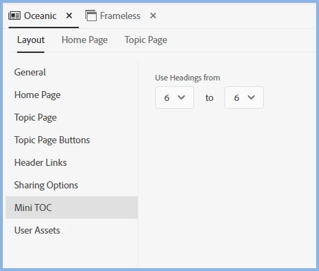

    As long as you don't use the style Heading 6, try this.
    Nothing to show so the whole Mini TOC was not shown.
    My test was quick so test a bit more.

    Mar 8, 2023 4:14 PM UTC
    Ah this could be a good solution, thank you!
