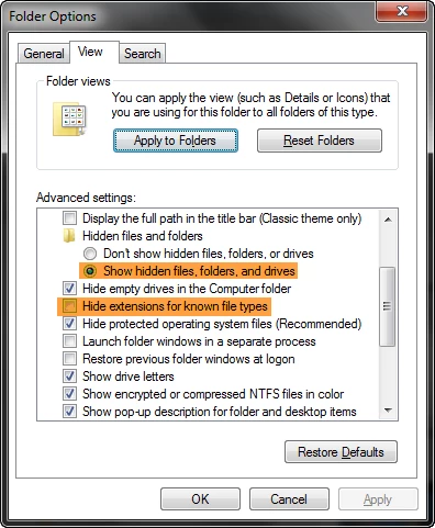

    For my money. the simplest way to see the folder and files is to right-click on a file in the Project Manager and choose "Explore". That should drop you into Windows Explorer right there at the location your project is. If you have done this and you don't see any files, you likely need to tweak the Windows Explorer application by clicking Organize > Folder and Search Options > View tab. There are options there that govern what Windows will show you.
    Personally, I have mine set as follows:
    See if making those changes seems to help.
