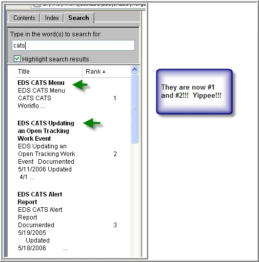

I've been asked to give screen shots of the 'solution' and the results.  So...here goes!

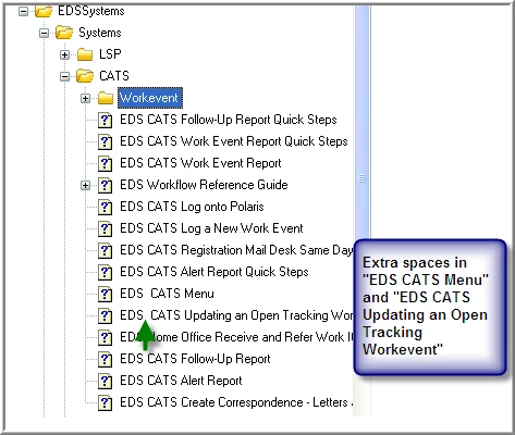

The altered titles appear like this in the Project Manager:
The search results will then have these two topics at the top, and the Menu file before the Updating file since M comes before U.
It appears to work well.

Helen...the magical "hidden character" is a space.  Inside the title, not the leading character.  If I add an extra space I can force the Menu to the top - yippee!!!
I added the space to the menu and to a "u" name and got them both to the top.
This appears to be 'the solution'.  Thank you Helen for suggesting hidden characters...the perfect hidden one is one you can't see to begin with!
Thanks to all who suggested solutions and tried options.  I would love to see a checkbox below the 'exclude from search' that says "weigh this extra" or something like that...but...appears that we can run with this.
