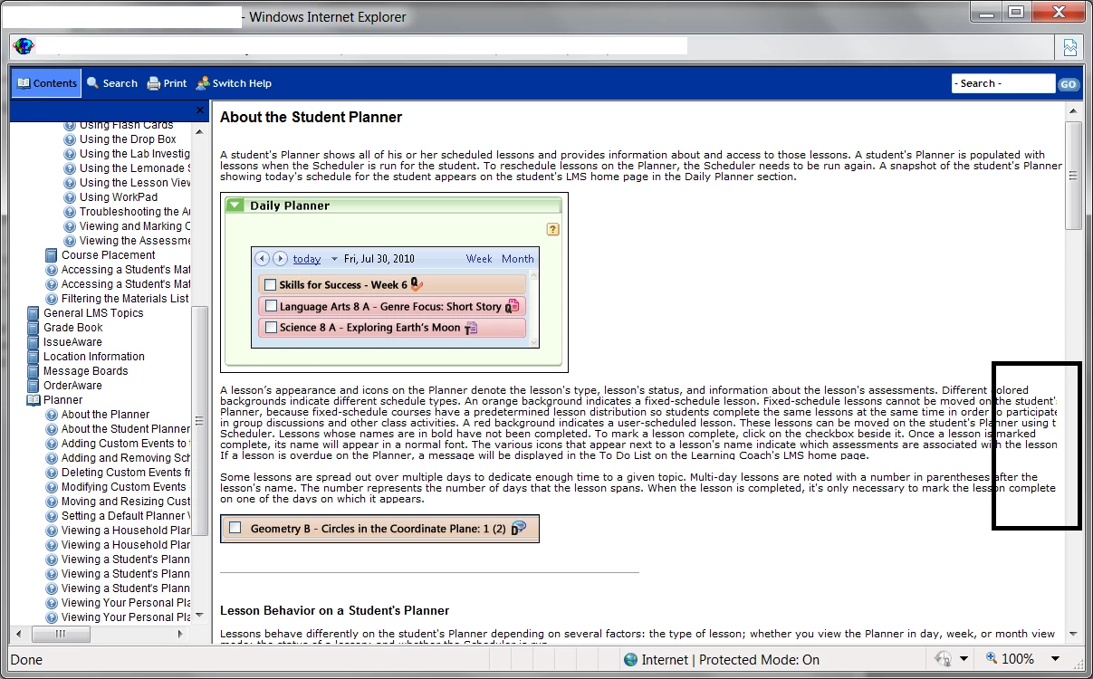

I use RoboHelp 8.  When I view my RoboHelp-created pages on IE8 on an older computer, the text wraps fine, regardless of how you resize the Web browser window.  However, recently I tried viewing the same pages on IE8 on a newer computer that has a monitor with higher resolution and a wider screen and I noticed that the end of nearly every line of text gets slightly obscured no matter how you resize the browser window.  I have two questions:
1) Is this problem simply the result of the differences in the monitors?  Or is it the result of some other issue I'm not aware of?
2) How do I prevent this from happening?  What do I need to do to my pages in RoboHelp?  Currently, I don't set a width for the text on my pages -- even when I use tables -- so it generally goes 100% and just wraps.
Here is an example of the problem:

The issue doesn't seem to appear in Firefox, only with IE8 on a wide-screen monitor so maybe this is just an IE issue.  Has anyone else noticed this issue?

Perhaps try configuring the table so there is a right margin you can adjust? That would work for tables.
For the text, I'm wondering if perhaps you could introduce a DIV tag and specify the width so it would cause the wrapping to work properly.
Cheers... Rick

It might be easier to directly add a style to the body element. Then you don't need to modify the topics, only a style sheet. Add
body { padding-right: 10px; }
to your css. Amend the value to increase or decrease the white space.

Willam -- So I would just add that bit of code to the HTML for my stylesheet and it should pad the whole page regardless of whether the text is in tables or not?
