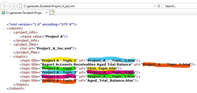

    Thank you for replying @Peter Grainge . So when I generate my project, there are (as I discovered today) two files that list all the files in the output: the .htm file with the same title as the project, and the file ending in "_prj.xml". These are highlighted here for my test project:
    The Project_A_prj.xml is the easiest to see, so I'll use that for this example. When opened, you can see that the topic is associated with the wrong URL; they are jumbled. I used different colors to match the topic title with the correct URL (I ran out of colors so the unhighlited ones go together as well):  The other file I mentioned with this information (Project_A.htm) contains the same (mis)information. I'm wondering A) if either the Project_A.htm or Project_A_prj.xml file is used for pushing to Zendesk (or any content only output), B) if this URL mixup is indeed a bug, and C) if that bug may be the cause of getting blank/empty articles when they're put in Zendesk. I understand that the answer to C is more of a Zendesk issue. Does this clarify my problem a little better?

    @TechWriter1025 Please use the photo icon to insert images within the post. Seeing an image inline with the text makes it easier for anyone answering or viewing the post.
    Are you saying that one link is to a topic in another project? I have added your images inline but I'm still not clear about the issue. Perhaps if you tell us which link and where the target is, we can get somewhere.
