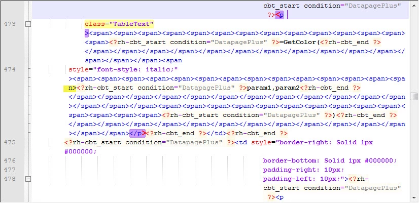

I'm trying to survive a zombie <span> apocalypse! Here's what a portion of one of my .htm topics in my project looks like inside of the Notepad++ text editor:
Notice that these span tags are empty. My understanding is that tags without any attributes in them don't do anything. Right?

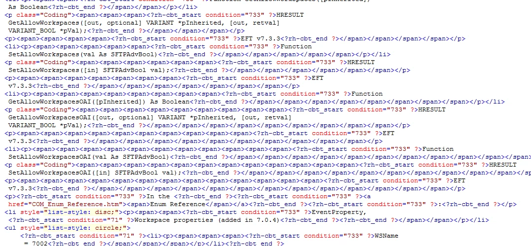

Does anyone know what's causing this? There was no visual indication this was happening inside the WYSIWYG editor in RH. It's only now when we submitted the files for localization, that our localization department ran into them when preparing this project for localization. Here's what they saw:
Any ideas why this is happening and on how to fix it? To fix it, I'm thinking of doing a Find and Replace across my project in Notepad++ and removing any empty <span> tag, and then opening the project back up inside of the RH editor. I'm hoping this would then remove the closing unmatched </span>?

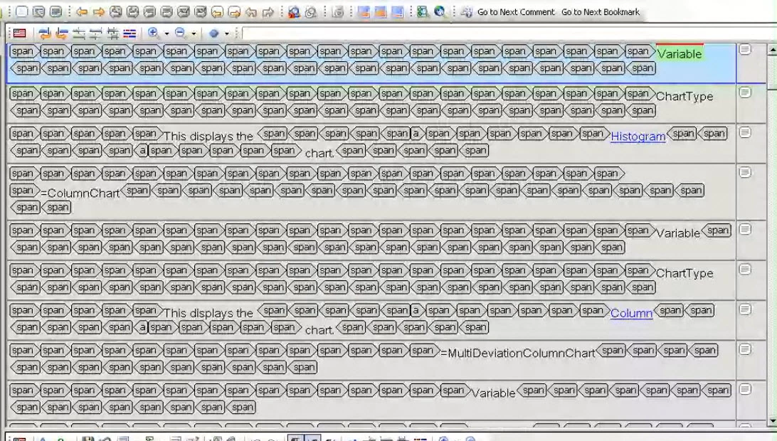

I am using Robohelp 2017 on Windows 10 OS. I copied a short phrase from one topic to another topic, and the phrase had conditional text on it. I went off to do something else, and when I went back to that topic, the Zombie Span Tag Apocalypse had happened!
I saw this thread and cheered for Willam Van Weeldon, but the link is broken. :-(
I know how to fix it; my question is how can I make RoboHelp stop trying to fix my code?! There should be a check box or even a registry setting to turn that bug--or feature--off.
