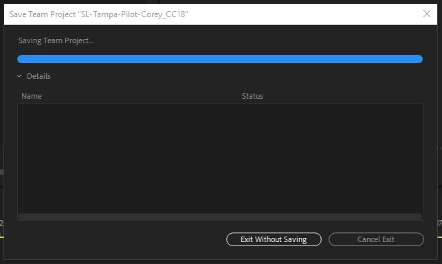

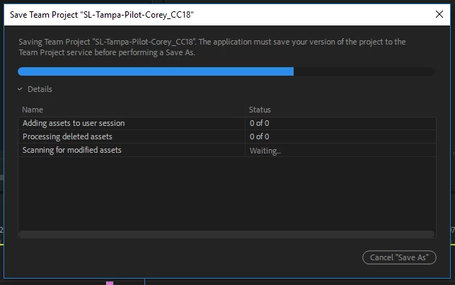

I am having this issue on CC18 now. Left project open overnight and still sitting there. Canceled out, tried the other methods mentioned above, still stuck like OP stated on trying to save. It also gives you different states of being stuck on different methods of trying to save or export another way as shown in the attached images.
I did find that upon closing Premiere out and reopening, I was prompted to re-log into CC. When I did this, I was able to make changes and share them on the teams project that would not share prior. Anyone else have to log back in upon shutting down? Or check to see if they were still logged in on the main CC App?
Richards way of "select assets then export selected to a standard project" did work for me. I was able to save any changes that would have been lost closing out the teams project that would not save.
