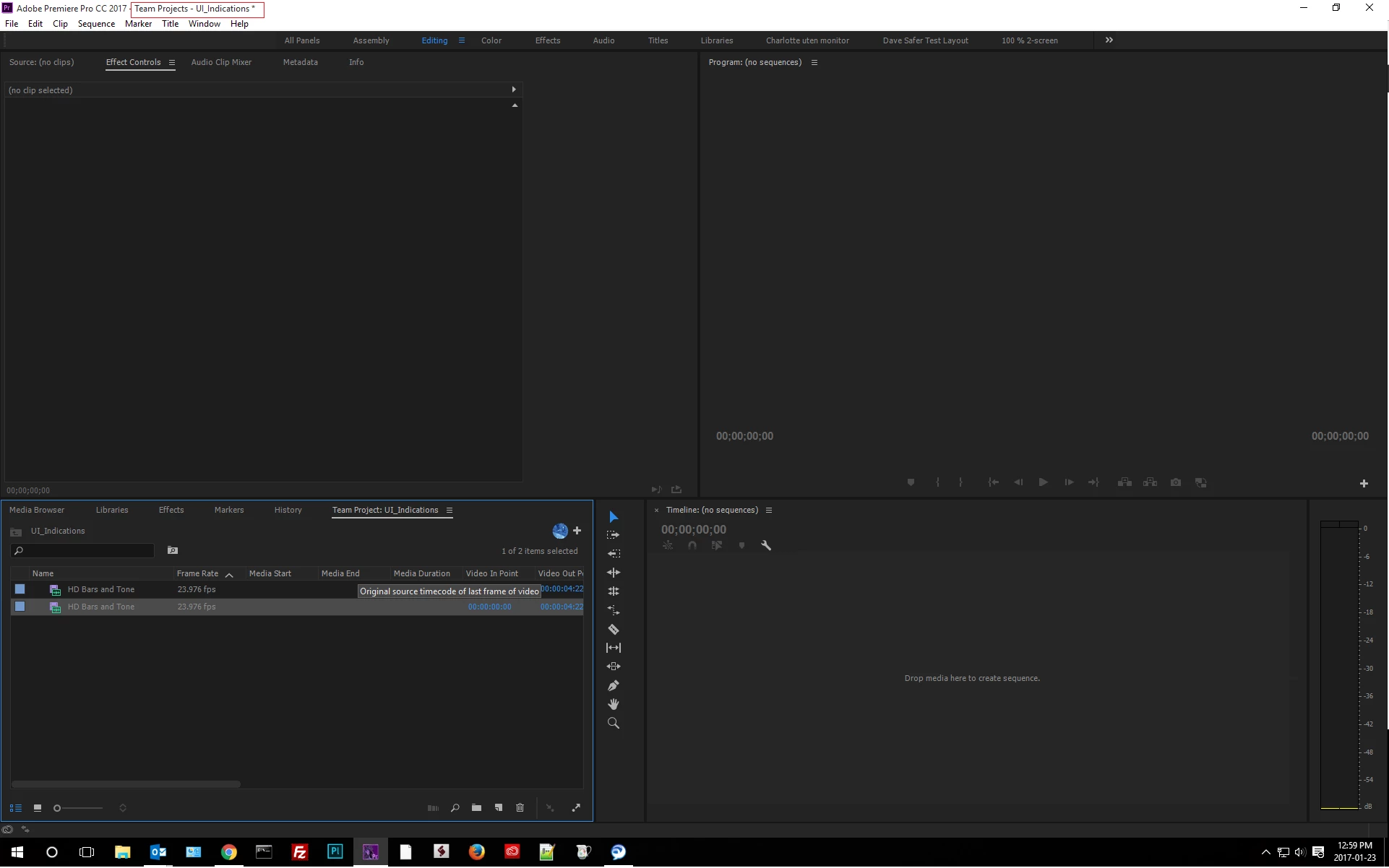

To verify if the current state of the team project has been saved locally, check the title bar of the application. If there is no asterisk sign (*) with the name of team project, that means your team project has been saved to your local drive. If it is present there, it means the saving is in progress and it should be completed in some time. Refer the screen shot.

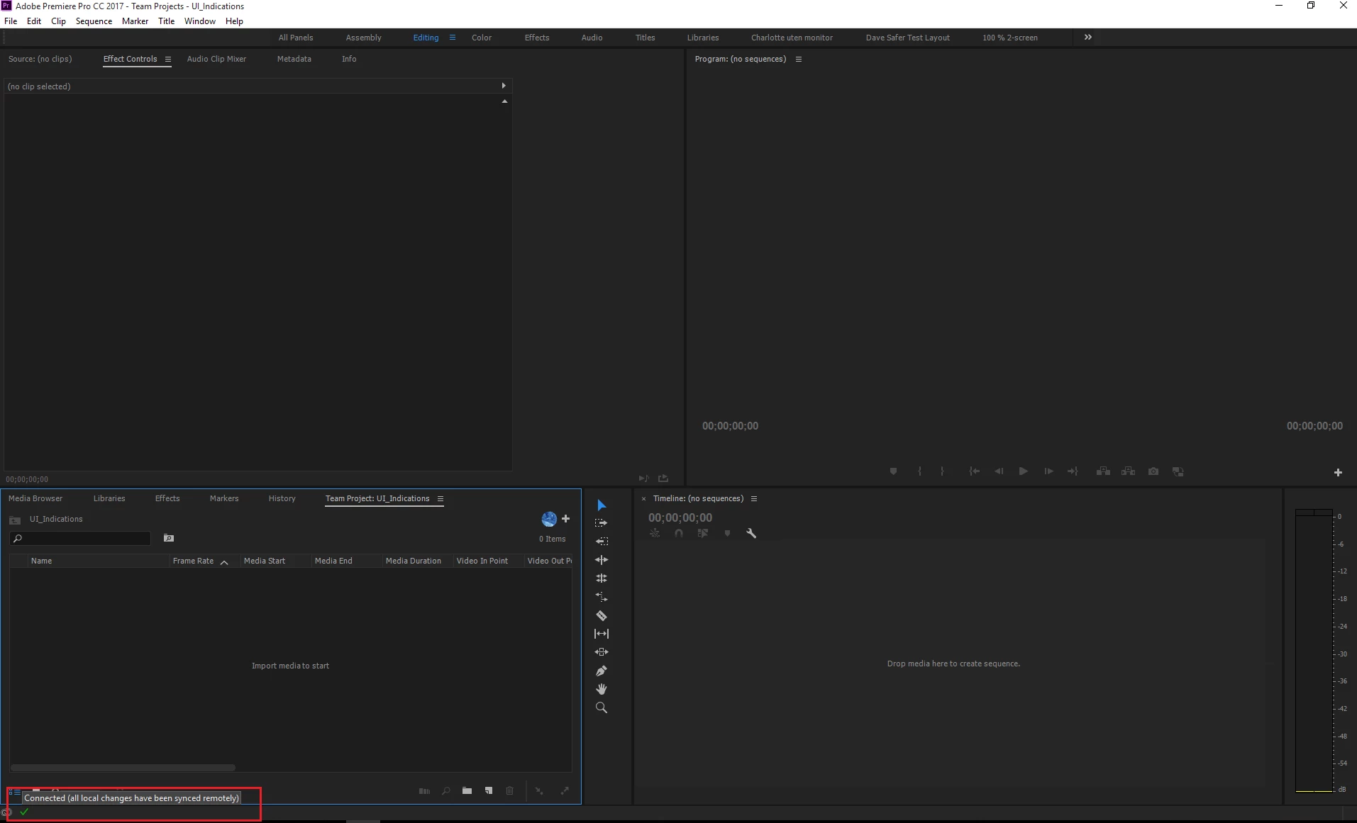

To verify if the current state of the team project has been saved to our remote server, check the sync status icon. If you see a green check mark, this indicates that your changes are safely saved to our remote server. This is also the indication that the team projects cache can be cleared now. (You should not have to clear the Team Project cache as this cache is generally of very small size). If there is any other icon there (other than the yellow warning triangle which I would explain in a moment), then this means that the sync will be done shortly. There can be a delay of around 5 minutes but the sync to remote server should be done in that time. Refer the screen shot.

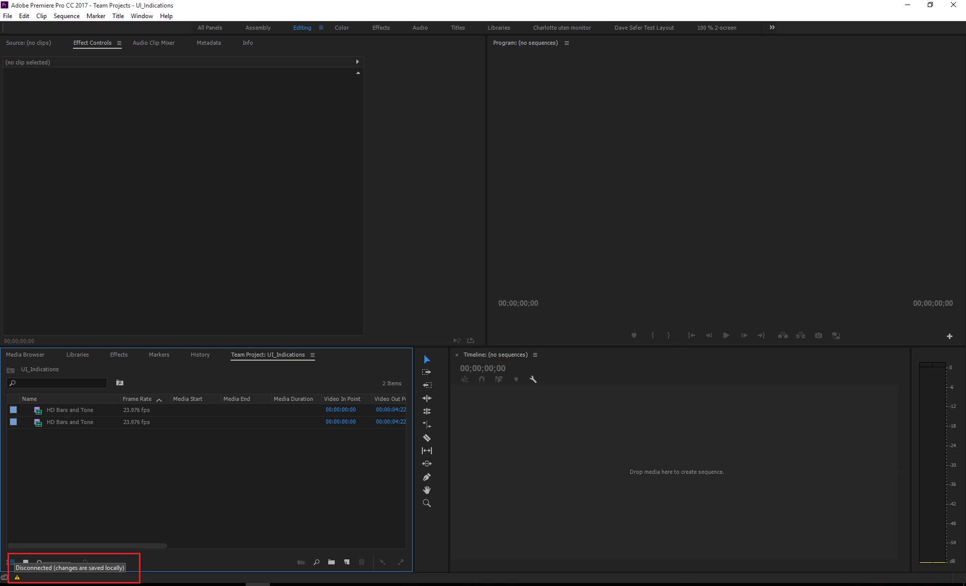

For any such kind of issues, there is one place to look out for and that would be the sync status control. It's the same place where you saw your green check mark icon. If you see a yellow warning triangle there, then all of your above issues can be explained. This warning triangle can come in two cases:
  1. You might be disconnected from Team Projects server. Hover over the yellow warning triangle. Refer the screenshot.
    This does not necessarily mean that you are not connected to Internet but this should be the first troubleshooting step for this case. Another possible cause for this state could be that you might be logged out of Creative Cloud Desktop application. To troubleshoot this, you can do the following:

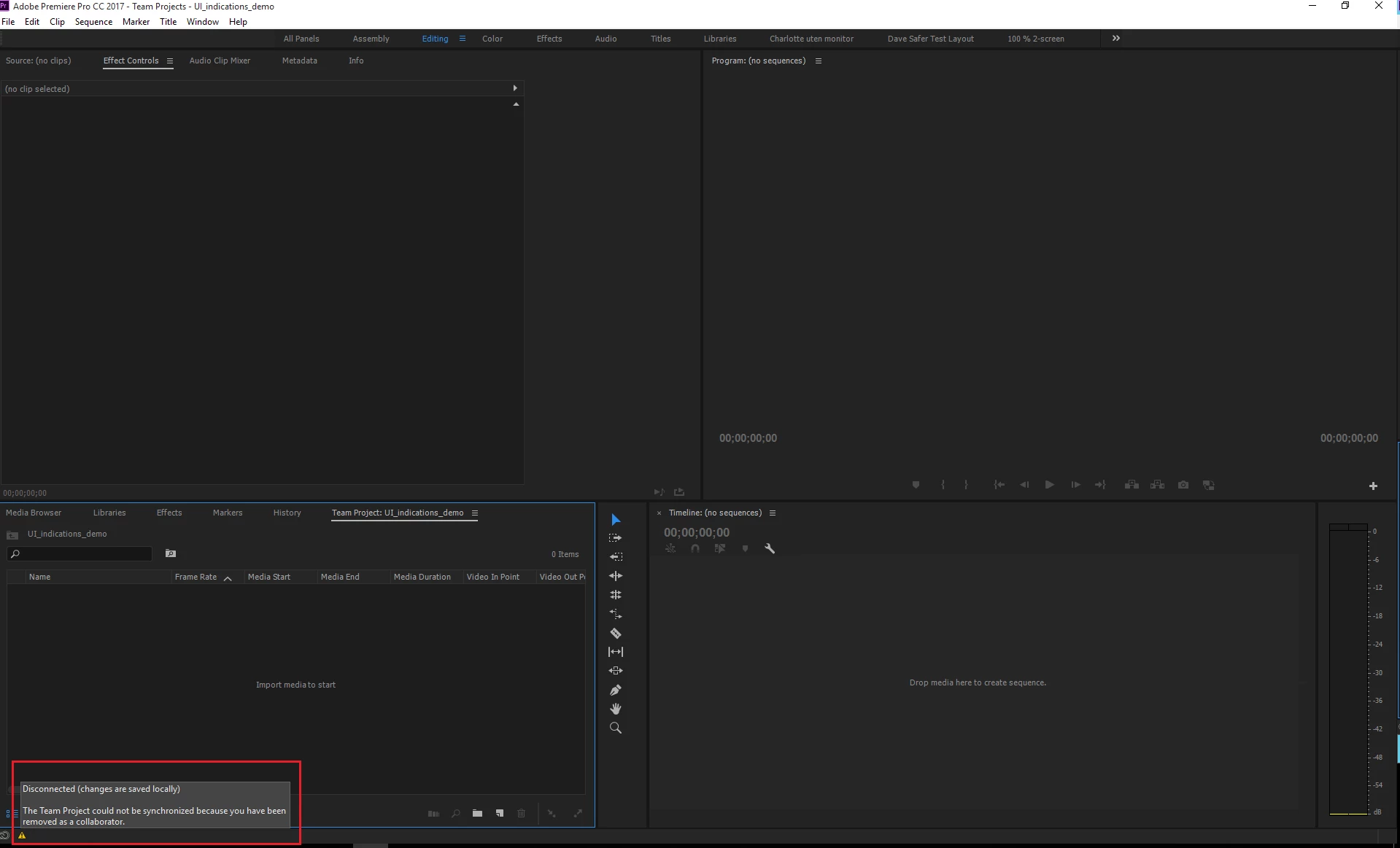

  2. You might have been removed as a collaborator of the team project. Hover over the yellow warning triangle. Refer the screenshot.
    It means that someone has removed you as the collaborator of the team project and you can no longer contribute to this team project. All the changes you have done so far can not be shared with anybody.

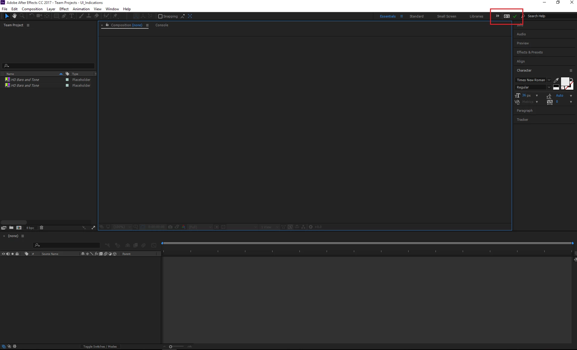

This sync status control icon is at different location in After Effects. Please refer the screen shot .
