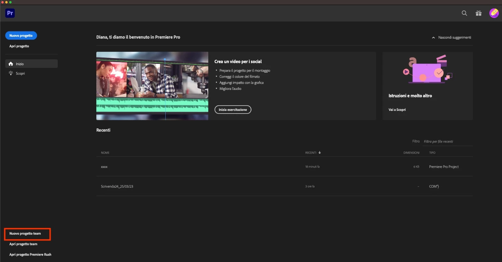

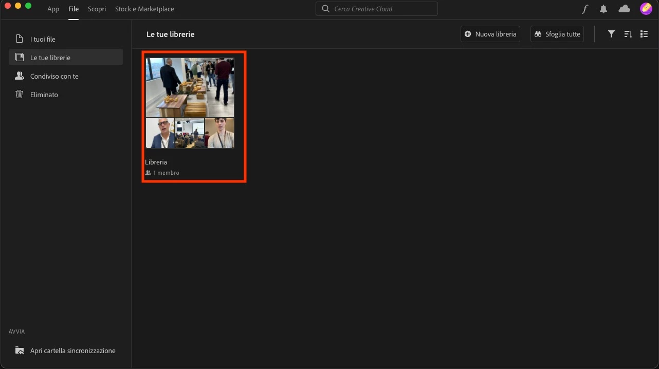

How it works team project and it's possible to work with the footage on adobe cloude?
Hi, i just download the new version of Premiere and i have not idea of how it works the collaborations with collegue in team project. Are there any tutorial? We want to work on the cloude cause we want are free to share all the projects and works everywhere we are.
Thanks a lot
Carola

Our help document should get you over the first hurdles with Team Projects:
Italian: Introduzione a Team Projects
english: Get started with Team Projects
