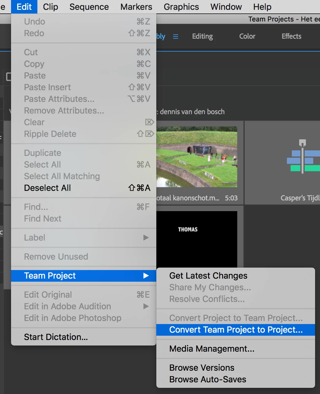

Joost van der Hoeven
Nov 6, 2017 2:27 PM UTC
You can convert a Team Project to a Project anytime. But this is a manual proces:

does converting it make it no longer a Team project or does it make a local copy of the project and keep it a Team project?
Nov 6, 2017 2:40 PM UTC
It will create a new local project form the Team Project. But you will be able to continue working in the team project. So it is good way to make 'local' versions, as you requested. Note that there are some limitations with the feature when you include Ae footage.
