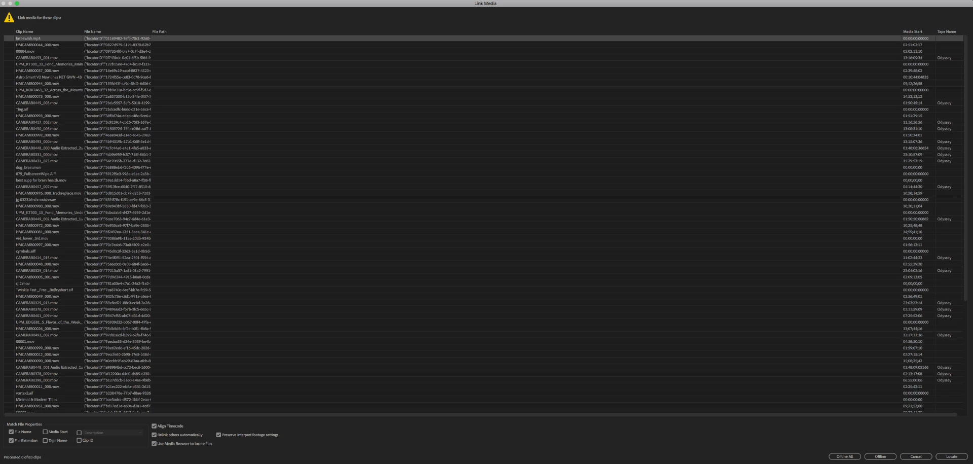

May 2, 2018 9:56 PM UTC
I am having the same issue.
Here is a photo of our issue.
