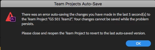

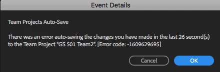

The setup- A team project was created and shared among 5 editors - all editors are in the same location with separate CC logins managed under our enterprise account. All media is on one shared storage RAID that all computers are connected to. PPro and CC versions are all current as of 04/17/18. The project was started yesterday (04/16/18) and we almost immediately began getting "auto-save" errors:

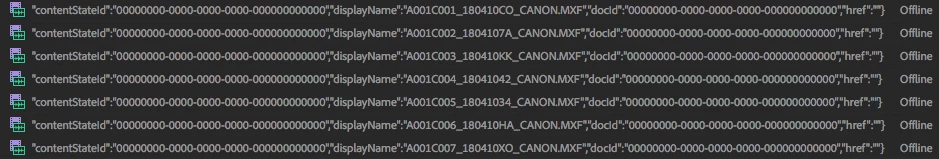

We also began to have media issues where a warning would pop up saying media was offline- The instruction was to use Team Project > Media Management to resolve this. Upon opening "Media Management" there was a list of clips proceeded with some sort of meta-data looking jibberish and the file name in the middle of it somewhere:
There does not seem to be any way to link this media back, but more strange, there is no indication of offline media existing anywhere in the project. The media "listed" in this view appears to be only the first camera roll of "A" and "B" cameras for the first day of shooting...Second camera rolls and subsequent days/other media is not reflected in this list. The media itself is still online and editable in the project, but this error keeps popping up and we cannot find or ignore these duplicate/error prone clips that seem to be burned into our project somewhere.

    As for the auto-save issue, I have seen that. If you're not already aware, one very important thing to understand is that Team Projects use "Versions" and "Auto-Saves." "Versions" are what you and your team push to the cloud. "Auto-Saves" are the local version of each user's database.
    The solution I found is to delete the Team Projects Local Hub, which is where that local database lives. When you do that, launch Premiere, and open the Team Project again, it will be as if you're opening the Team Project on a new computer or a new user account for the first time—it'll take longer to open because that local database is being recreated. You can do this without harm to your Team Project or your other team members' work. On the Mac that folder is here: ~/Library/Application Support/Adobe/Common/Team Projects Local Hub, if you're on Windows I suspect it will be in the User\AppData\Roaming\Adobe\Common folder.
    Doing this has solved a few different issues for me, and it's allowed me to pull down the latest "clean" version from the cloud. Hopefully it will also solve your issue.
