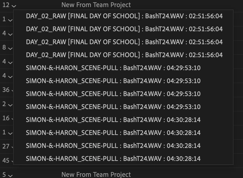

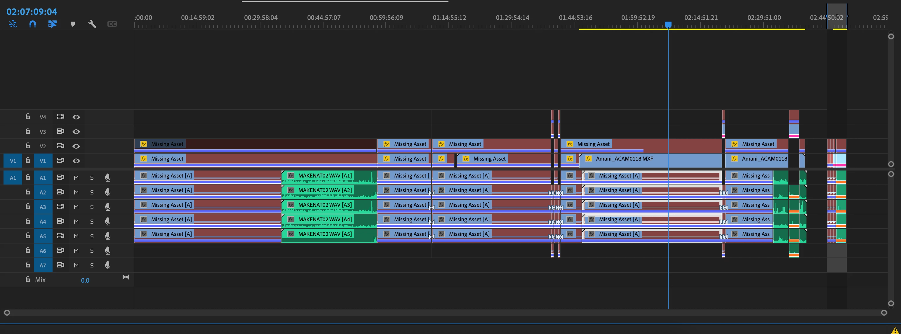

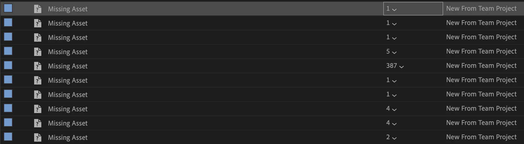

Working in a Team Project and recently invited a new editor to work in the project. He was able to connect successfully and got into the project no problem. The issue began once he Shared Changes for the first time. When I took his changes all of a sudden "MISSING ASSET" media began populating in my project and replacing certain chunks of media (both video and audio) in certain sequences. They weren't any sequences that he made changes to either, seems to be just random ones. Whats strange is they are treated like offline media, but they don't display a filepath and can't be relinked to anything. Also if you look at the Video or Audio usage for the "MISSING ASSET" it will give you the exact media and timecode it is replacing, like it's teasing you or something. I've attached some screenshots to clarify a bit. Wondering if anyone else has experienced something like this. I appreciate any guidance y'all can give!

I've run into this problem but now in version 24.2.1 (Build 2). After having trouble with Teams Project, I converted it to a local project and it appeared fine. But then somehow I opened the file up again and all the media in my sequences were replaced by references to "Missing Asset" elements that don't have any paths or filenames so I can't relink them. I actually took a look at the original Team Project and saw the same problem there, so I went back a version to where there weren't missing assets, but as soon as I create a new Team Project from that older version, the "Missing Asset" popped up again. All my sequences are affected.

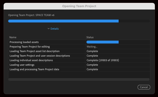

We've been having similar problems. Team project takes over 20 minutes to open. When it does often all assets are missing. Beach ball spinning. System crashing. Have reinstalled Premier and reset all settings but that didn't help. I used a standard Premier Project backup and created a new Team Project but this too did not solve the problem. The project is just stuck here as seen in the attached screenshot.

Regarding load performance, in a nutshell - The bigger a project grows the longer it takes to scan project items for changes. Especially, if a project contains large and complex sequences (including several backup copies of them).
To keep the sync/load time as small as possible we recommend working with 'Linked Team Projects'. This lets you split a large Team Project into smaller more manageable projects that only contain relevant sequences and media for current editing needs. It is generally a good idea to keep the number of backup sequence low or ‘park’ them in linked projects - “Linked Team Projects”.
