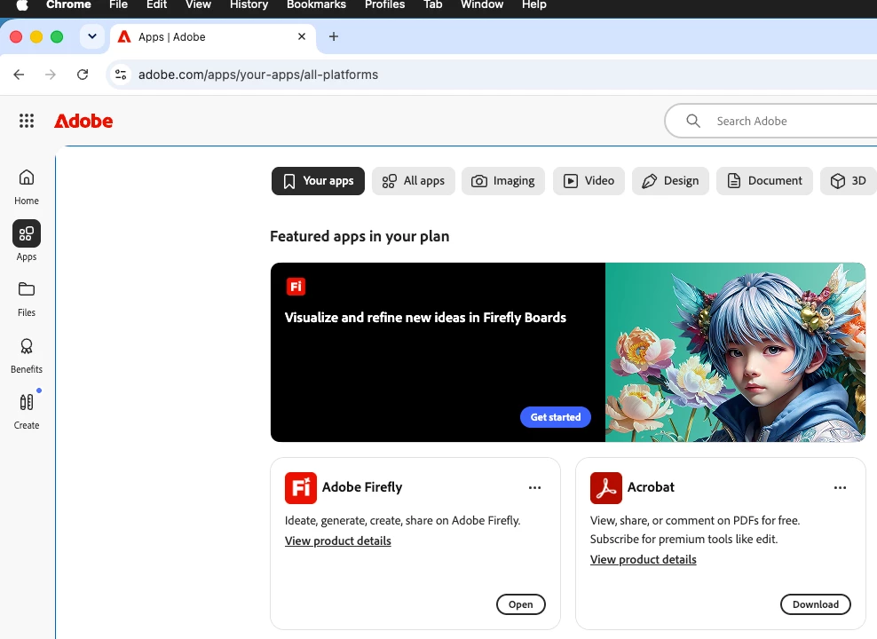

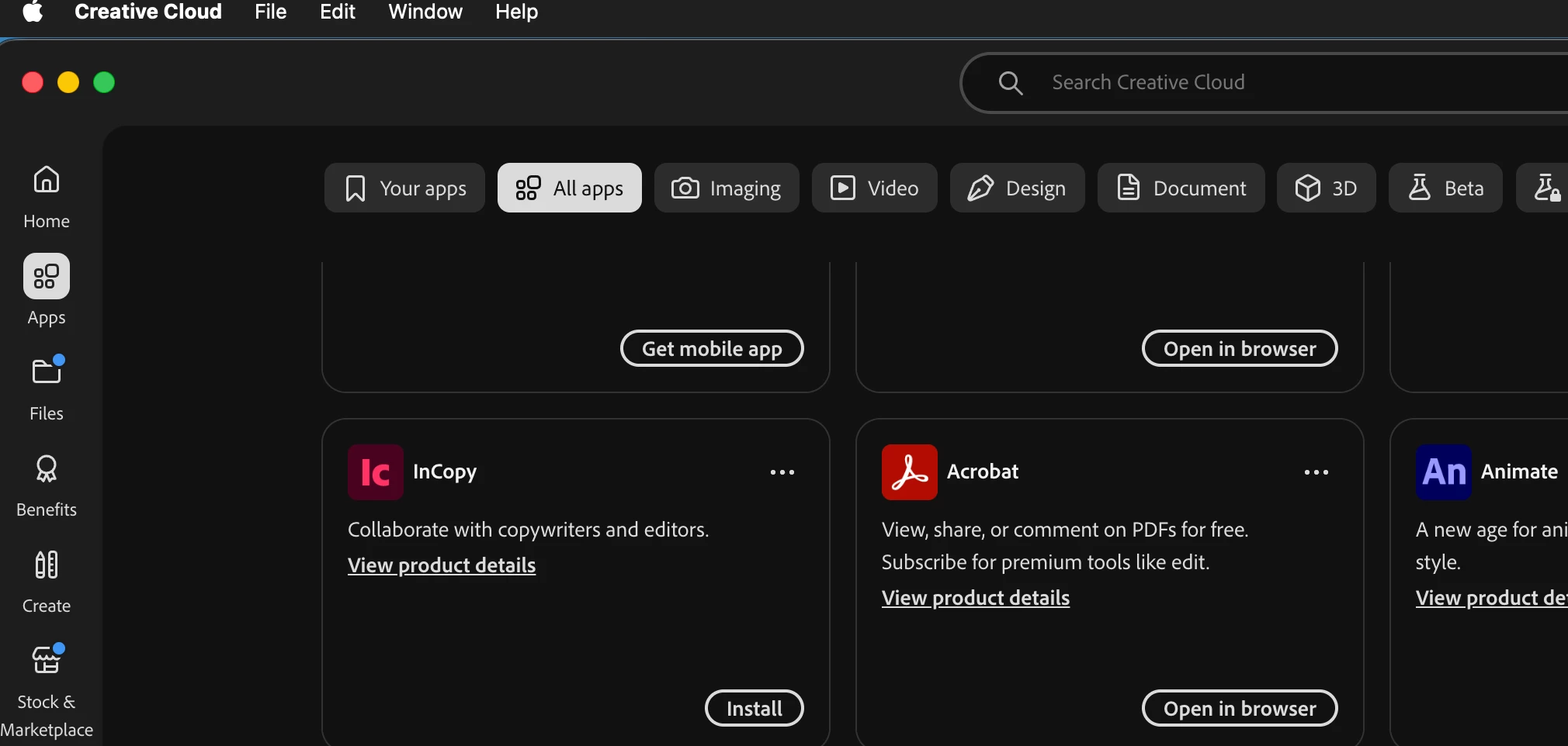

​@Gruvpix that direct link in the ‘Best Answer’ is a link to the ‘Entrerprise’ account. If you don’t have an ‘Enterprise’ account, it isn’t going to work. If you are on an individual account, then I would log out of Adobe account. Clear your history, cache and cookies on all your web browser and log back into adobe.com.
I would remove the ‘Enterprise Acrobat’ and install from the Creative Cloud Desktop App
or if you prefer adobe.com: https://www.adobe.com/apps/your-apps/all-platforms/pdp/acrobat?source=apps

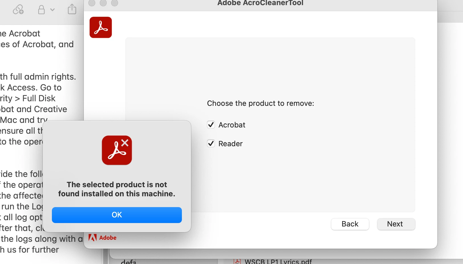

Thank you.  It worked, with the exception of the Acrobat Cleaner tool--which did not open.
