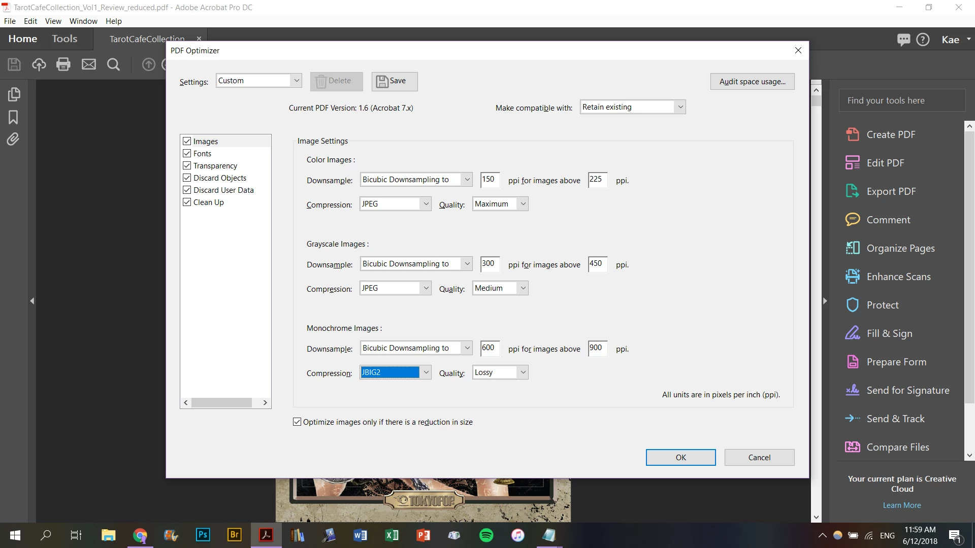

I've been using Acrobat for several years to create PDFs of graphic novels, and have optimization settings that reduced the file size without degrading the quality of the images like most third party optimization programs and websites do. The attached settings have worked perfectly for a long time, dropping a 250Mb file to closer to 40Mb.
Unfortunately they've just stopped working out of the blue. I assume there must have been some kind of update, but now there's zero change in file size, which is a big problem for my job. I've tried uninstalling and reinstalling with no luck.
Can anyone offer any insight or suggestions for other settings I can adjust to reduce file size without compromising image quality?
Amal.

This is happening with multiple PDFs. I even repeated the process with a PDF I'd made in the pass that optimized properly, and this time it didn't.
I've got the most up to date version; 2022.003.20282 for Windows. I'll try repairing and resetting and come back to let you know if it worked or not. Thanks!

None of these options worked for me, unfortunately. Still zero change in file size, even using the exact same source files that I know worked before.
