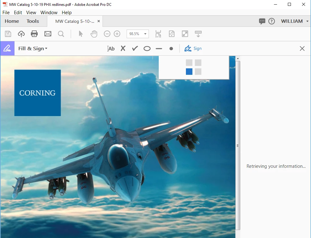

I am unable to add a signature to PDFs in Acrobat Pro DC as the Sign option in the Fill & Sign tool does not load. I am signed into my Adobe account when using Acrobat Pro DC. I have given it ample time (10+ minutes) but it never loads. My local IT for my company has uninstalled and re-installed Acrobat Pro DC without that resolving the issue. I see that slow loading is listed in the known issues (ever since Dec 2015 without a solution listed - 4055402) but this implies it does eventually load whereas my issue is it never loads. Attached is a screenshot of what it looks like when I use the Sign option. The Sign option did work on my previous Adobe Acrobat Reader DC but I need to be able to use Pro DC for editing PDF and signing them. I am currently using version 2018.011.20055

From your snapshot it seems that you are not on the latest version of Acrobat. Could you please update to the latest version. Go to Help > Check for updates.

July 17, 2018
Hello Williamp,
We're sorry for the trouble you had with Adobe Acrobat and Fill&Sign option not loading. Please sign out from Acrobat and then reboot the machine. Sign back in with your Adobe ID and password in Acrobat and check.
Try resetting the Adobe Reader's Preferences once and reboot the machine, to reset the Preferences, refer to How to reset Acrobat Preference settings to default.
Also, repair the installation files of Adobe Reader from help>repair installation, reboot the machine after repair.
Is it possible to connect the machine to a different network environment like a guest wireless network or to a mobile hotspot?
Is Fill&Sign option is not loading on a specific PDF or with all the PDF files? What is the version of OS installed?
Try removing Acrobat using Acrobat cleaner tool Download Adobe Reader and Acrobat Cleaner Tool - Adobe Labs
Reboot the machine and install Acrobat back from Download Pro or Standard versions of Acrobat DC | Non-subscription
let us know how it goes and share your observation.
Anand Sri.
codyh32627995
July 27, 2018
I am actually having the exact same issue, except with Acrobat 2017 instead of DC. I have tried all suggestions in your post, AnandSri , but even after complete re-installation, Fill & Sign is not working.
It is not loading properly on any PDF files that I've tried. I'm using the latest version of Acrobat 2017 with Windows 7 SP1 installed.
