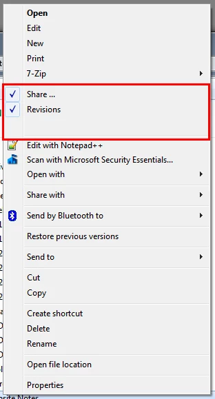

The right-click context menu to combine files was available two days ago at the latest.  When I tried to use it today, the placeholder is there, but there is no text.  The entry still functions as intended, it's just annoying.  See the pic.
Any thoughts? <edit> I've done an uninstall/reinstall, manually registered the .dll, and done inverted jumping jacks, all to no avail.

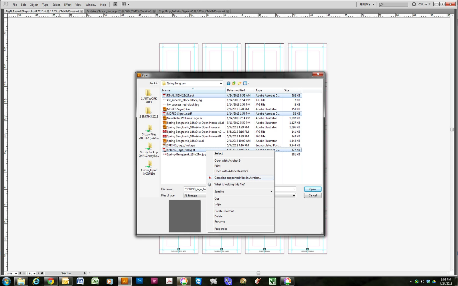

Same problem but check this out.  In the windows dialog the wording for "Combine supported files in Acrobat" is gone but when you go to the open dialog within illustrator or acrobat it shows up just fine and works as intended.  The windows dialog is still working for me but has a 16 file limit, once over that, the combine files window will not open. The context menu displays correctly within Adobe Reader but does not work at all, even under 16 files.
Hope this gets fixed soon! I've been using it for years. Also, I'm using Acrobat Pro 9, with Windows 7, 64bit.
April 25, 2013
You're right. I just tried a combine in Acrobat 9.5.4. The combine context menu option appears within the tool.
